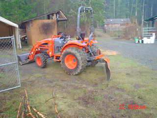

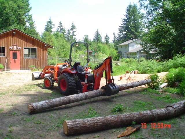

No idea the area you live in. When I was looking for my tractor I took a Saturday and visited the Kioti, Kubota and John Deere dealers in my area. The furthest away was the Kioti dealer, about 2 1/2 hour drive away. This is my first tractor and had never used or even driven one before so wanted to get it right, other wise it could be a big mistake. Just like a car, ask to drive the tractors that are comparable in size. It took me about six months to make up my mind and am very happy with my 2008CK 35 HST. Got 182 hours on it now. In some cases you are paying as much as a car for your tractor, most people would visit several dealerships and take vehicles out for a test drive. That would be the best way for you to decide witch one is best suited to your needs.
