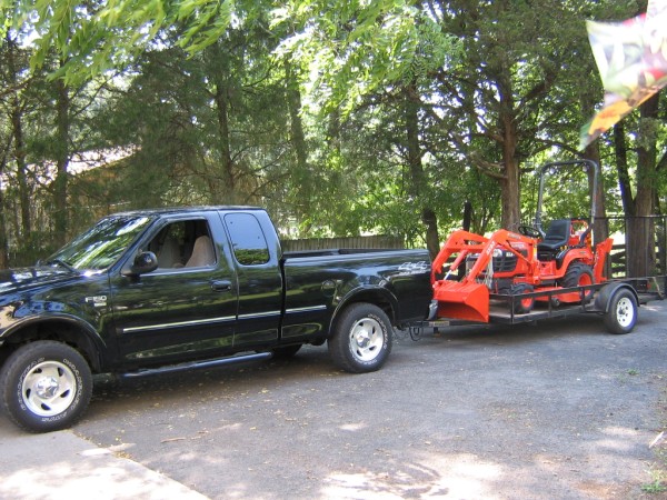

Like my BX23 you're BX24 w/MMM tips the scales at around 2500lbs so if you're only going to haul the BX24 the bare minimum you can go with is with a 3500lb single axle and that is if the trailer itself weighs in at less than 1000 lbs. As for size, this depends upon whether the BX will have a MMM or not. The obsolute bare minimum for a BX TLB w/a 60" MMM would be a 6x12 w/a single 3500lb axle.
This is what I have, it is a very tight fit and I don't take it into heavy traffic.
This is the bare minimum and works for short infrequent hauls but if you are going to haul long distances and/or in stop and go traffic I highly recommend a twin axle 7000 lb 6x16 or a more versatile car hauler. Either with at least one set of electric brakes and a controller in your tow vehicle. You'll be well under capacity and be able to stop nearly as good as if you weren't pulling a tractor on a trailer. This is the safest way to go and my recommendation.
