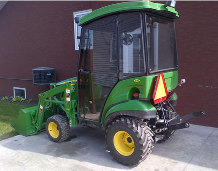

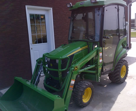

Since you have a separate 1026R for winter use the hardcab would be a nice addition. Hopefully you won't have to many slopes to deal with. With the led lighting upgrades the 40 amp alternator should work fine.
Here's two pictures of the cab from Jodale Perry's website.
