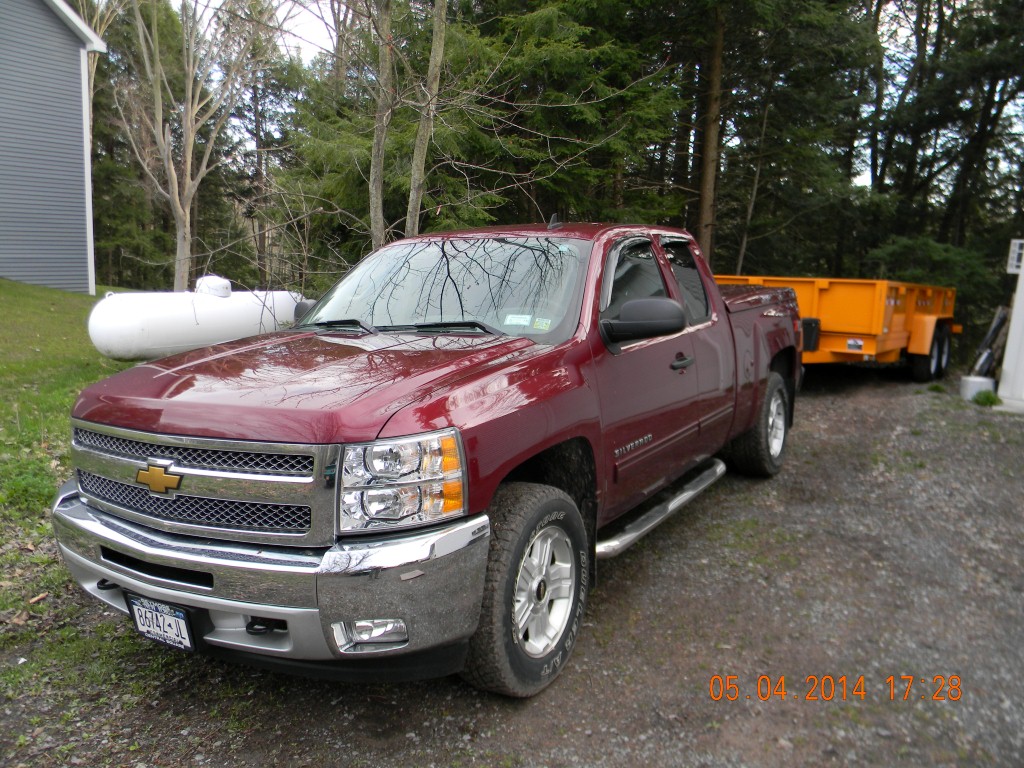

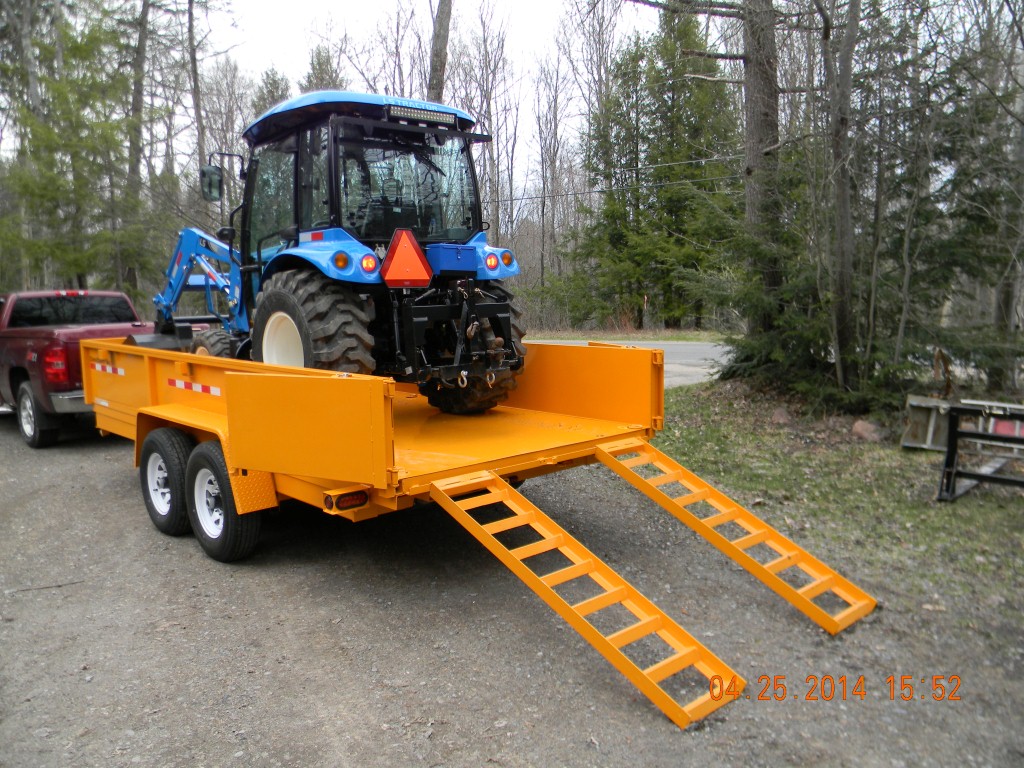

Nice truck. About the same color as my 2013 Chevy 1500 Ext cab LT 4x4. (Ruby red metallic). Mine is rated to tow 9600 lb. with the package I bought. At present I usually haul about 7K which is my trailer and tractor but have occasionally hauled a full size pickup or SUV pushing the weight to closer to 8K. Most all of my towing has been under 30 miles each way and I haven't had any problems. The trailer I just mentioned is a 20' tilt bed. I did just buy a dump trailer (attached) and it weighs about 800 lb more than my tilt bed that will put my towing weight with tractor at about 7900 lb. If I ever want to fill the dump trailer I'll have to use another truck to tow with because it would be over the 1/2 T tow rating.
Looking at tractordata's site a T433 and T503 weigh about the same. Add the weight of the loader and your pushing about 6K plus your trailer weight. I don't know what your truck has for a tow rating but it should be close to mine and be able to handle the TYM in question.

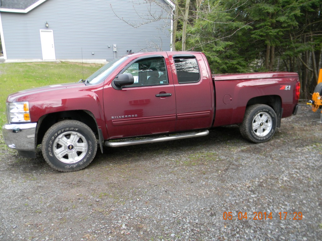

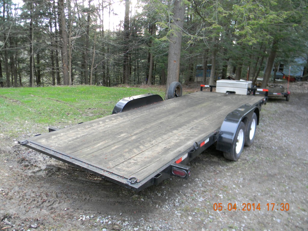

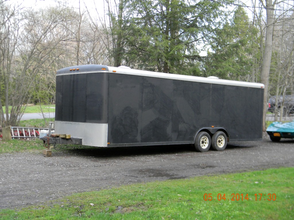

Here's a list I pulled from Ford for a 2013 Supercab F150. As you can see there are a lot of variables.
Just look up your trucks wheelbase, engine, and rear end ratio to get your tow rating.
Here's some pics of my truck, 20' tilt bed, and 24' enclosed trailers.
