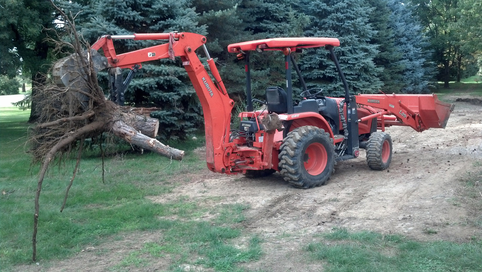

Have you talked with the company to make sure their mounting plate will fit your backhoe dipper stick?
I put a similar mechanical thumb on my L39 and it has been immensely useful.
