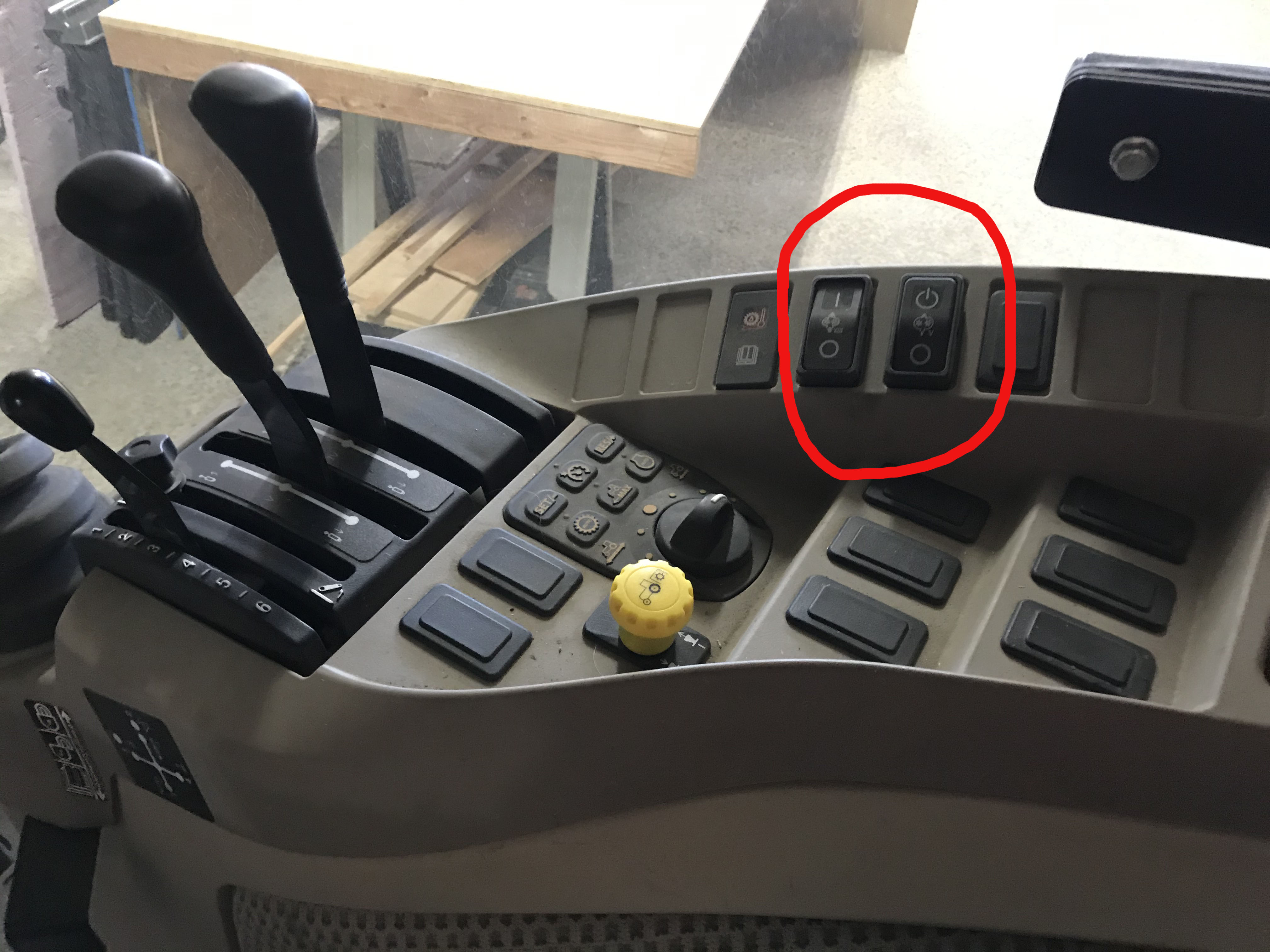

I had the dealer add some hydraulics on my JD 4052R last fall- a third function on the loader for a grapple and 4th and 5th on that back for a top and tilt kit. Grapple works great. This weekend I installed a top and tilt kit from Fit Rite (I highly recommend Fit Rite). The top and tilt also work great.

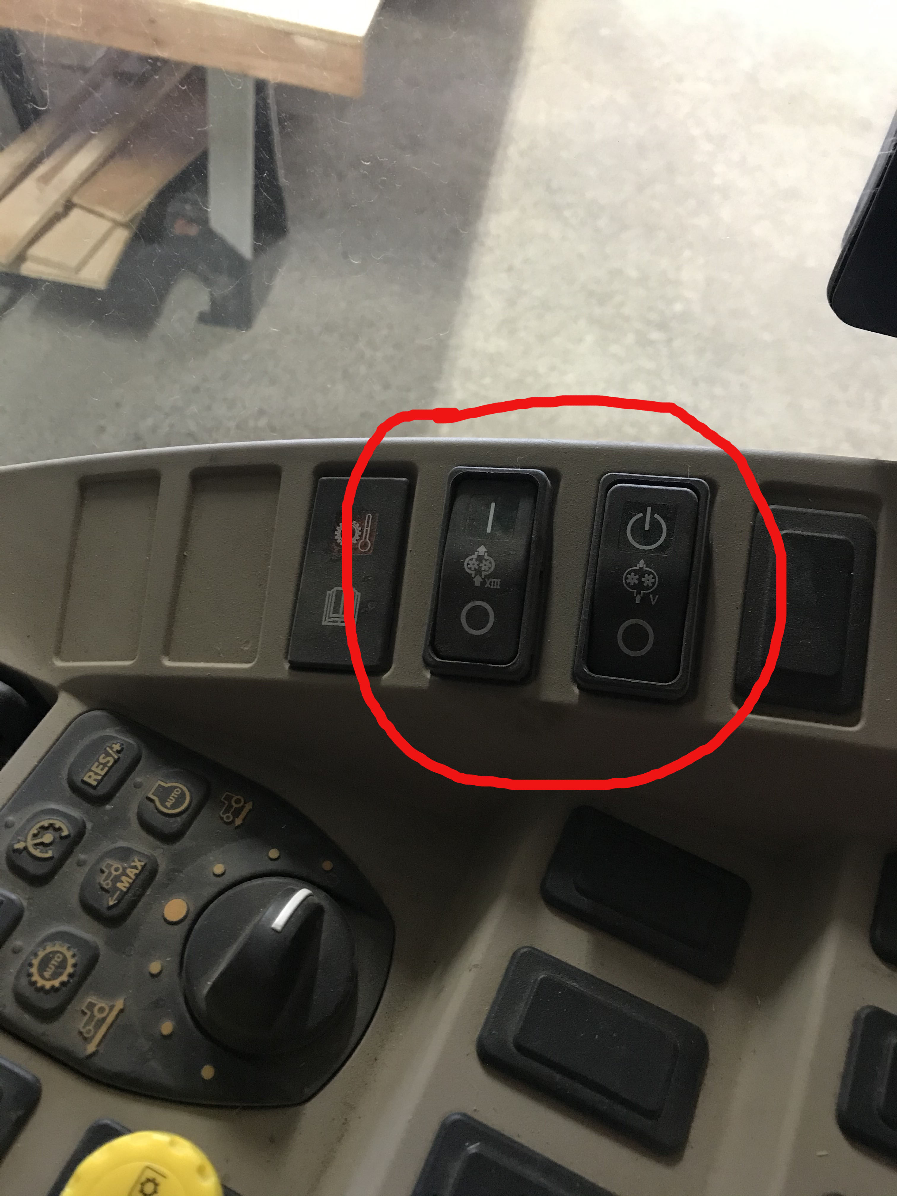

The pictures show the control levers for the 4th and 5th SCVs and also 2 buttons [marked] that I am not sure about the function. The third function switch is on the loader control. I took these pictures to the service manager at the dealership who scratched his head, looked online, and told me they shut the 4th and 5th function on and off. Tried the buttons again- functions still work with them off. One of them may turn off the grapple- I have not tried that. Have looked at the owner's manual but don't understand what is written.
Can anybody tell me how to use these buttons?
OMLVU28780 According to this, it looks like those are continuous flow switches.

Thanks Blue Knife. Now I understand what the service manager meant.
