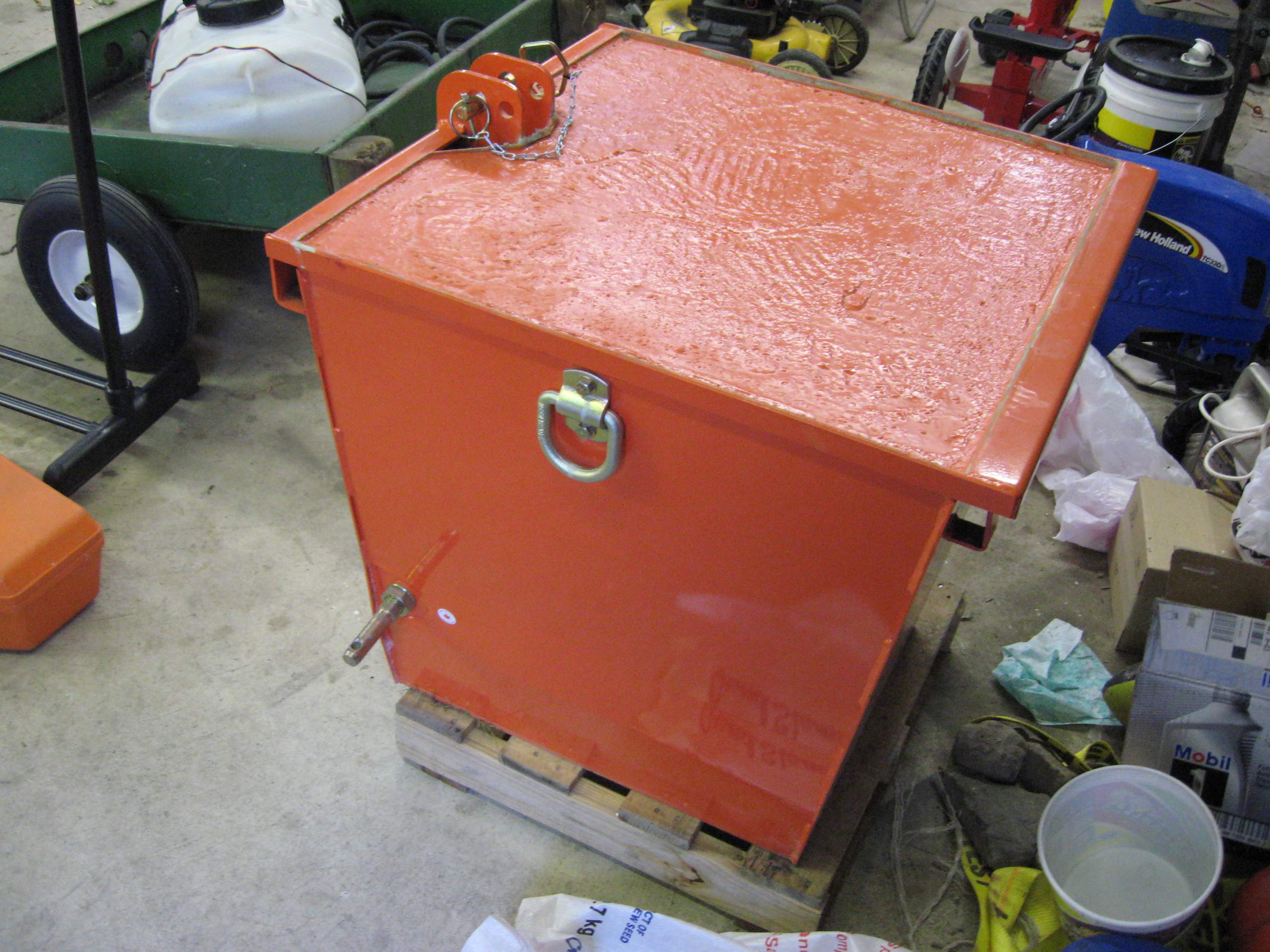

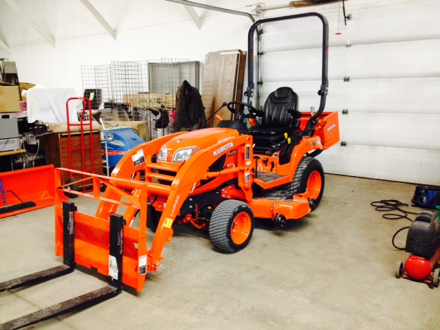

I am new to all of this and will soon be using the loader and pallet forks. I have the factory ballast box but am not sure what to put in it for weight. i was thinking sandbags,but sure would appreciate knowing what others do.
Thank you in advance...

I used cement. Philip.

Sand is often used. Sand is wetted with water to adjust total ballast weight. With sand, weight adjustment is easy.
You do not want any form of ballast material that can potentially shift.
You do not want more weight than you need high in the Ballast Box.
Once you determined weight you need from considerable experience, replace sand with concrete if you want.

I used 8x16" cement blocks from Home Depot. I added 300 lbs for about 10 bucks. You can adjust or remove it quickly.
