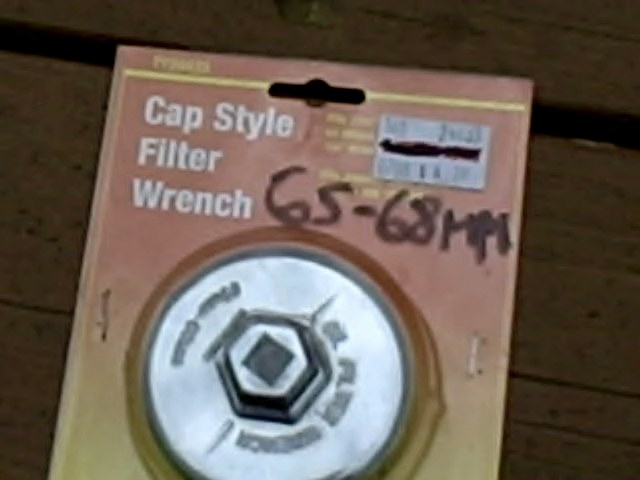

Pave,
If you plan on doing your own oil changes for the BX, you can save yourself a lot of aggravation by buying a cap-style oil filter wrench with the size depicted. This way you won't have to mess with removing the guard, hood, and loader when you change the filter. You simply put it on the end of a ratchet extension; and go right in.
You'll like your BX25; they are like little pit bulls.
Good luck

/ What Do I Need To Know #11
Pave,
Good luck
Buy Performance Tools Standard Filter Wrench W54050 at Advance Auto Parts_____
This is the tool I use to remove oil filter on all of my equipment/tractors. It will fit over the Kubota filter without removing side panels or does for me. The harder you pull the tighter it gets.
