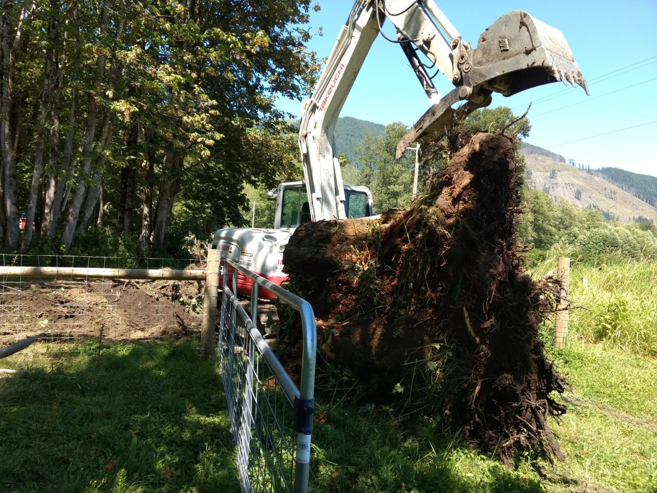

This is how you avoid breaking your 3pt with a backhoe:
The right tool for the job (excavator for digging). I compile a list of digging projects and then go rent an excavator. I feel that it's more cost-effective (for me) as I don't have to worry about maintaining or breaking my own equipment. I deal with stuff that NO CUT backhoe is going to touch: I'd also even say that NO industrial tractor with backhoe could touch.
