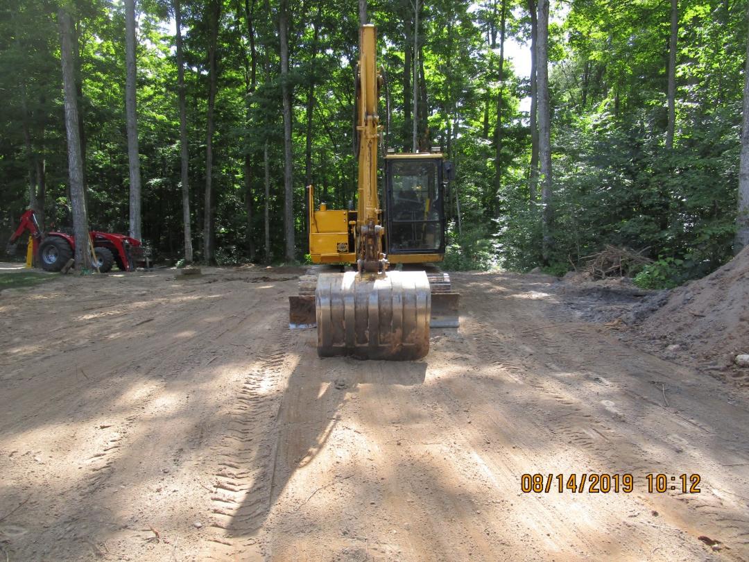

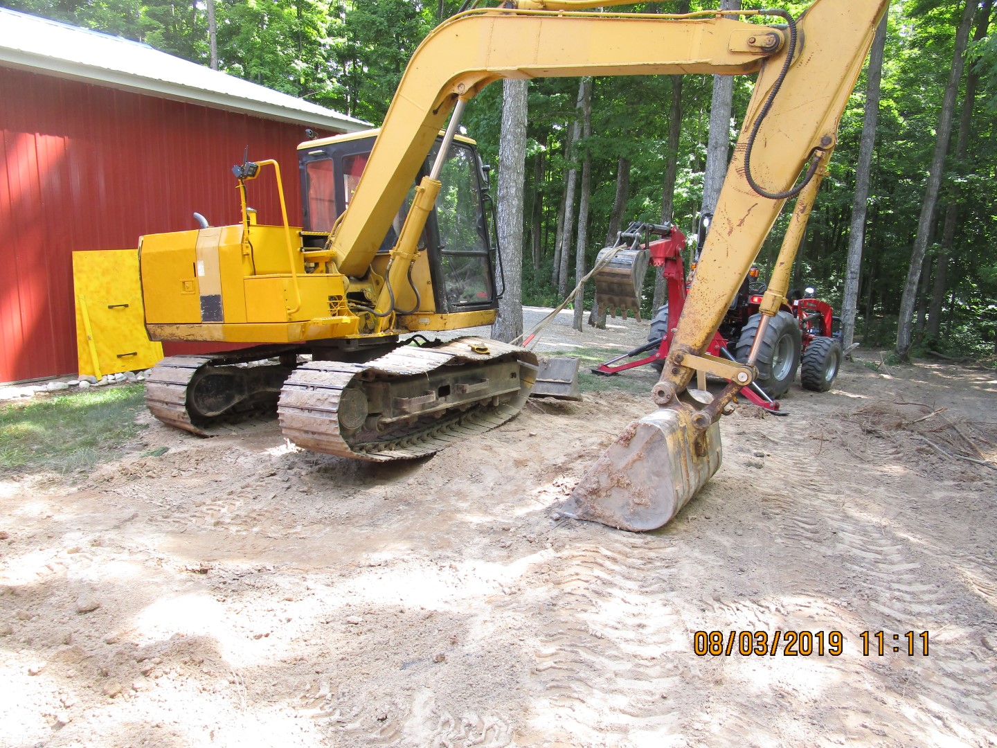

A lot of the smaller ' trailerable ' minis, those under say 6 tons or so, are real expensive. These are desirable by contractors that can pull them around on jobs with their pickup trucks or small dump trucks. And are usually priced like they are gold plated. You have to really hunt around to find a deal on one of these that is not all used up. You can find deals on very large excavator, those that are hard to move, more often. I bought an old 1991 Cat E70B 8 ton unit for $15K, and will probably have another $5K in it when I am done fixing it up to my liking. It fits in my barn going thru my 10X10' doors. Steel tracks last a long time, rubber ages sitting out in the sun. Steel has more front to back traction but tears up grass/pavement. Rubber can be a little better on sod, and definitely better on pavement. Good and bad things about each. Here is a picture of when I was putting the track back on. Someone was running it too loose, and still learning how to operate it....
Hours does not mean as much as how it was cared for, just like buying a tractor. A lot of companies lease a new excavator, and the 2000 hours might be the norm for when the lease is up. My unit had 5400 hours on it, and the Mitsubishi motor purrs like a kitten, and does not use a drop of oil. Pins and bushings were just replaced on everything, and everything is tight. Came with a 4' wide ditch bucket, and I have a new 20" bucket [ for digging stumps/trenching ] and manual thumb I will be putting on this Spring right after I get my trees downed/split/stacked for the winter of 2021. Nothing wrong with manual thumbs. Hydraulic thumbs are best if they pivot with the bucket, that way they line up with the bucket teeth in more than one spot. Mine has no problem throwing around the 4' bucket heaped with dirt at full reach, so I would think it would easily pick up 2000 pounds.

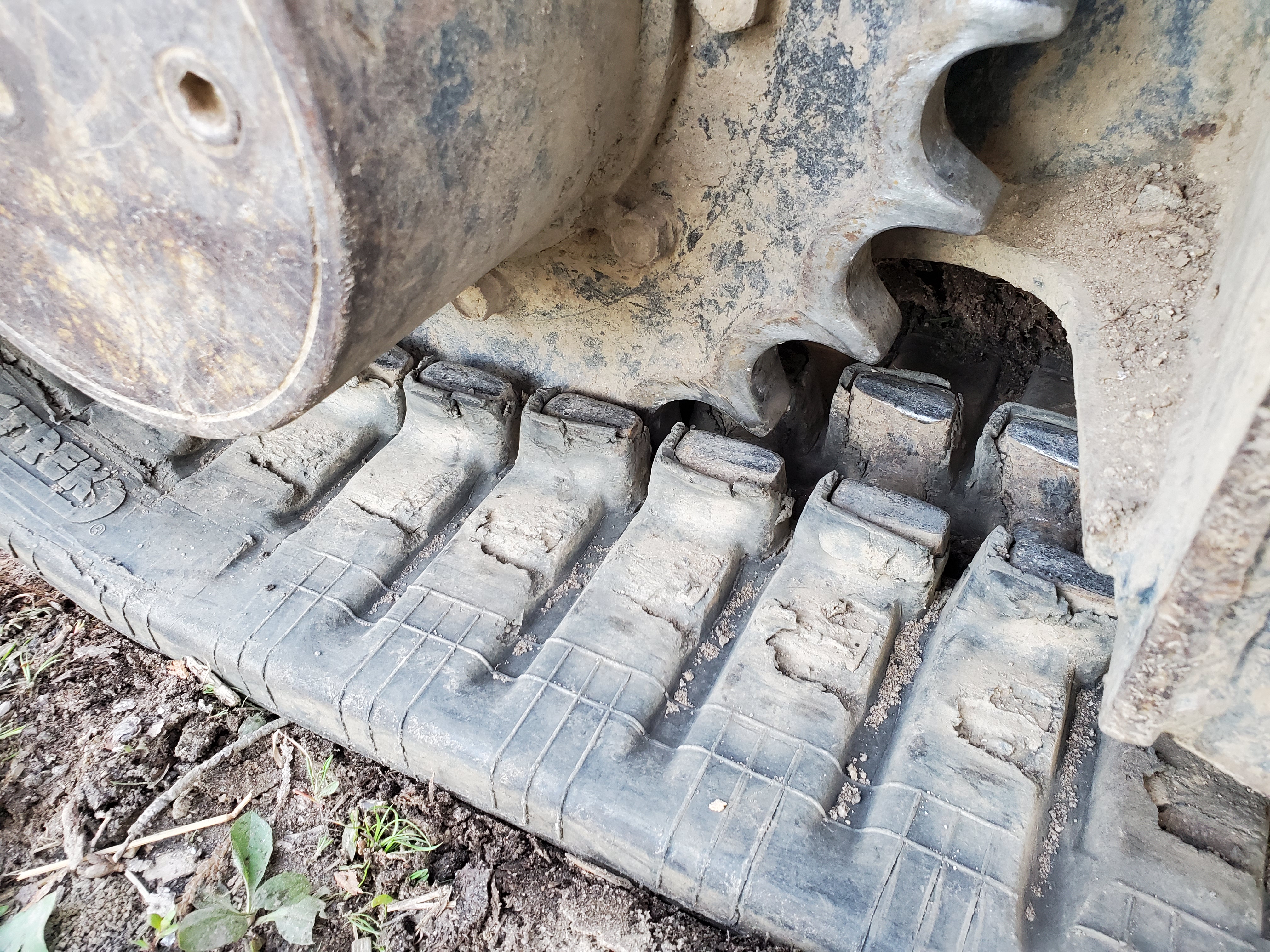

Any thoughts on these tracks? It looks a bit like a hot mess but the tracks only ave ~200 hours on them and the tread looks good.
   / what do i need to know before buying a used mini #8
Your undercarriage will be very expensive to fix, it would be worth your time to find or hire someone experienced in repairs to give a second look.
