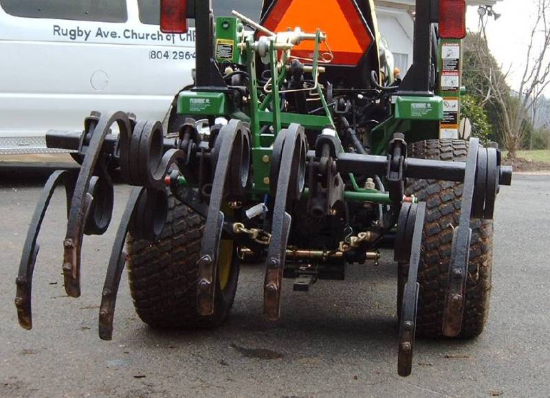

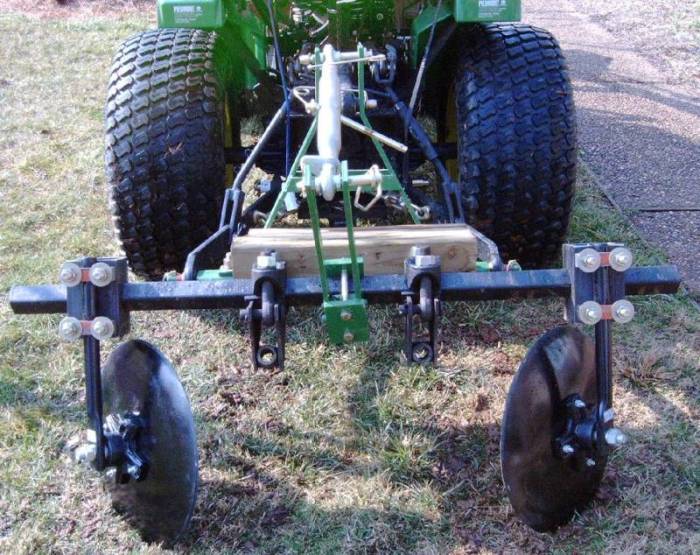

I made raised rows with 2 opposed disc hillers (pic attached). Before this, I chewed it all up with my soil ripper (pic attached).
This year, I put down plastic between the rows and mulched every raised row and didn't work it at all. Got one row of carrot seeds planted. Waiting for my potato seed to arrive. Corn won't go in until about mid April, first row anyway, then anothe row every week to 10 days. Beans, squash, okra will go in about the 1st of May.
My disc hiller/soil ripper outfit is combined now. I can rip the row with 3 plows while cleaning out between the rows. Did this once last year before planting. I went down to 12" discs for this. It's like the Disc Hiller picture but with smaller discs and 3 soil ripper plows between the discs. I can rotate the rig with 3 top links to adjust the disc and plow tilt.
