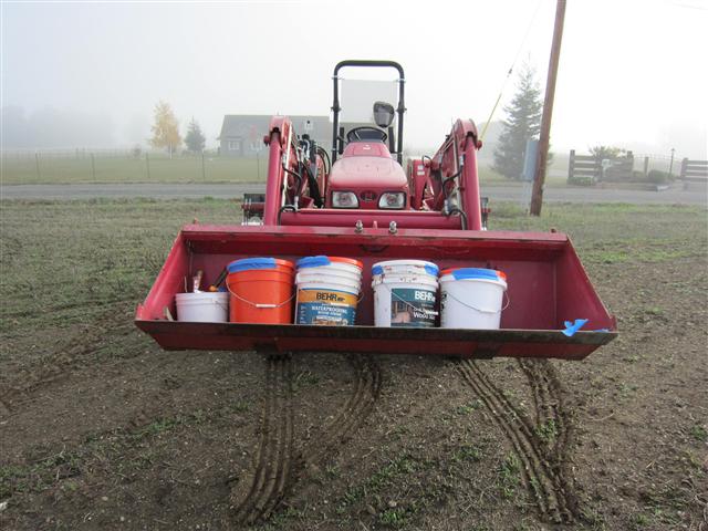

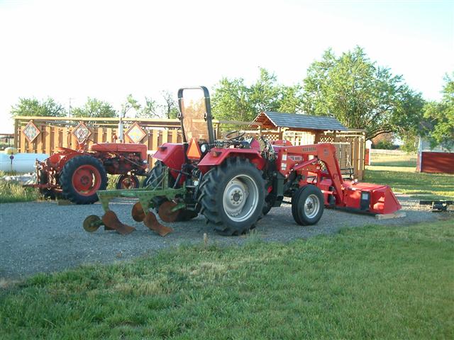

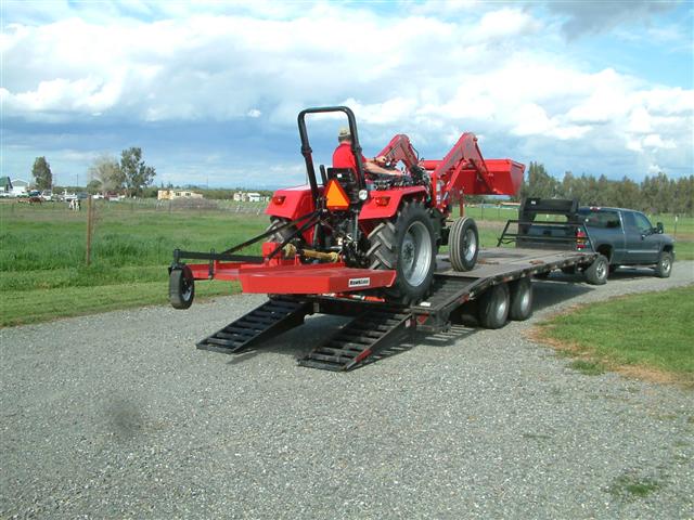

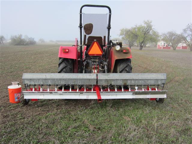

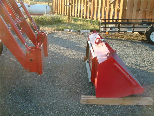

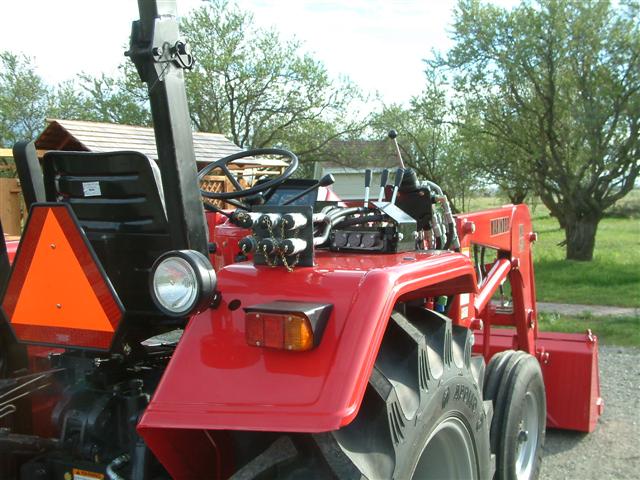

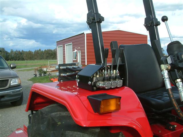

My 2008 Mahindra 5525 (54 hp engine, 45 hp pto, 2WD, power steering, gear tranny 8F/2R, triple rear hydraulic remotes) with the ML250 FEL (6-ft wide bucket, 2950 lb lift to 10.5 ft height, skid steer quick attach) and a Hawkline brush hog (6-ft wide) ran me about $20K new (just an example of what $20K might buy). You could handle 30 acres with something like this.
Good luck.

Very nice setup.:thumbsup:
