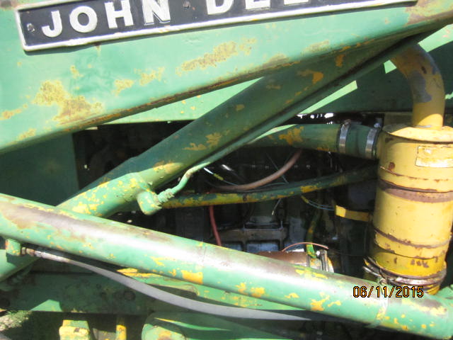

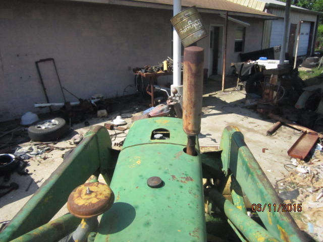

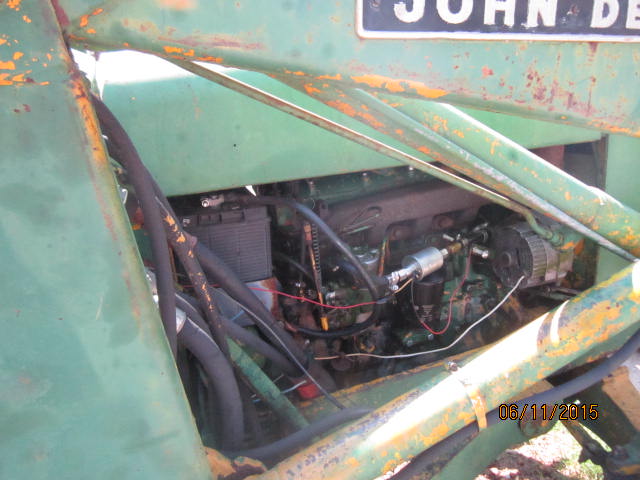

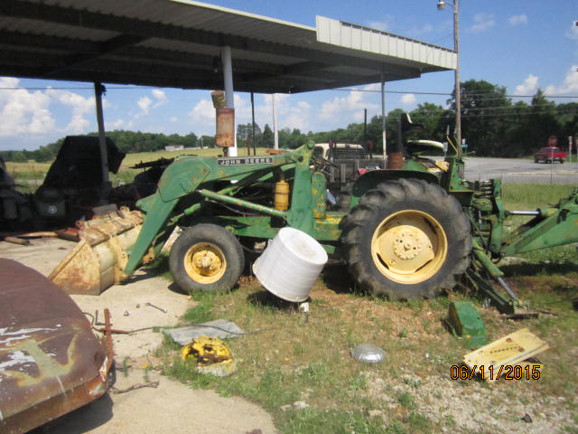

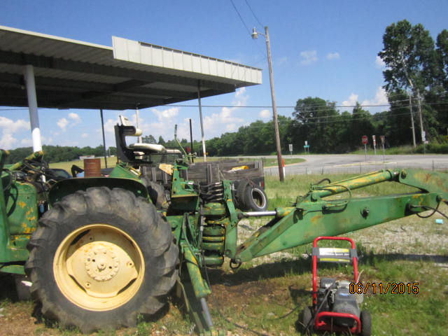

Ive bought a JD industrial tractor with a backhoe & loader. At first I thought it was a 3010. Then maybe a 3020. However the engine exhaust is on the wrong side. its a 4 cyl diesel The machine originally was painted yellow. J D backhoe 001.JPGJ D backhoe 002.JPGJ D backhoe 003.JPGJ D backhoe 004.JPGJ D backhoe 005.JPG

The guy I bought it from is the one who purchased it at state slurplus auction. He told me it was a 4020? He didn't know much about it. The backhoe & loader part work ok. the transmission works ok. the power steering & brakes don't work at all. You can steer it but its Armstrong steering. and the brakes have pedal but it like pushing on the concrete. The Front pump supplys oil to the backhoe & loader only & it has a hyd tank on the fender. two entirely different separated hyd systems, the transmission pump provides hyd power to the brakes & steering. I know it working because the trans had three clutch packs and they wouldn't work without pressure. the steering has a sector like a vehicle power steering. it don't have any hyd steering sectors.

Appears to be a 2010 or even a 1010. Probably 50 - 55 years old. Parts are getting very difficult to come by...at least for the ag models. The serial number plate on these models wer on the engine block.

I haven't been able to locate any serial numbers. I found where they should be at some one has removed them. the Vo tech has a body school and a diesel mech school. Ill bet those kids at the body school painted it. and they likely removed the brass plates. In kinda thinking it something that was special built to meet government bid specs?

I dunno this rig is pretty big. it likely weighs 6 tons. its not a Ag tractor. Its a industrial. the hard nose is made of 3/8 steel and it has a solid front axle. its built squat and low.
   / What Do I have? #10
Deere made industrial versions of the 1010 and 2010. Some were only loader tractors and some had backhoes. The cast iron nose was standard equipment for the industrial versions. They had heavier front axles as well. Also made crawler versions.
