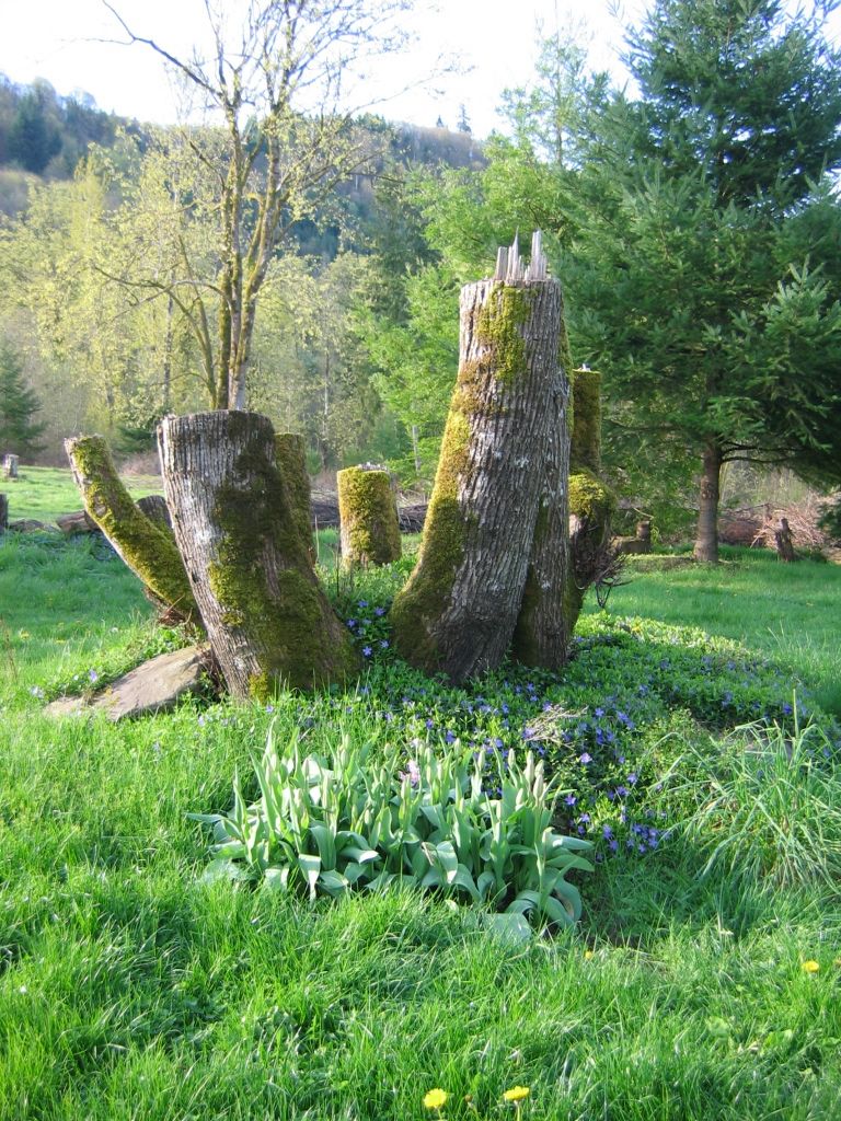

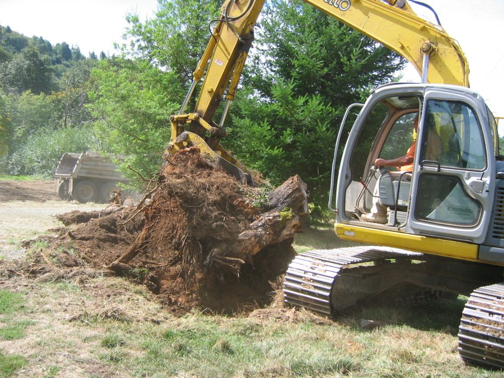

How big are your stumps, what kind of trees where they, and how much time do you have? It may make more sense to hire a larger excavator and operator... It took a guy 15 minutes to rip this bad boy out. Took him more time to move to the next stump. Also, once you got them what are you going to do with them? Burn Bury dump?
That said, I am not saying no to the back hoe. It is a great implement to have....
edit--- Aww heck.... The stumps shown are different. They are / were the same size but different so I am kinda fibbing... but you get the idea...
