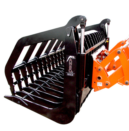

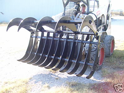

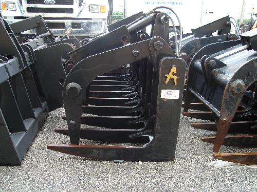

Here are a few to look at.
   / What direction for tips on a homemade grapple #7
looks like a lot of work but you will have something when your done but don't use anything less then armor plate for the metal
