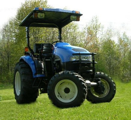

The easiest way to see if you have SuperSteer on that 45 is to fully turn the wheels left or right and see if the front axle articulates in the direction of the turn. If the axle does then you've been bit by the SuperSteer bug. See picture
