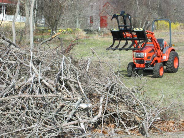

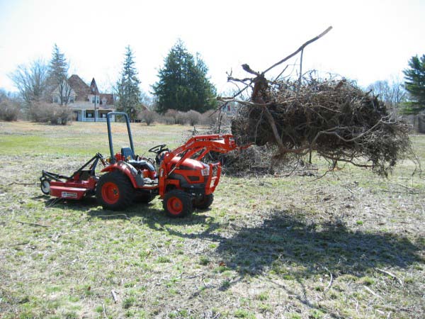

A healthy diet always includes fiber. Lots of it. Breakfast starts with a brush pile especially after your dad buys you a grapple. See photo.
Millonzi 48" QA light duty grapple. /forums/images/graemlins/cool.gif I don't know what they mean by light duty because this little guy is made of 3/8ths steel and is very capable. It weighs in at 285lbs (plus about 100 for the adapter) so maybe that is the light part. I'll post a few photos from the first day of work in replies to this post. To make a long story short, I cleared a 20x15x8ft brush pile in about 15-20 gulps and in a fraction of the time it would have taken with my FEL/bucket/toothbar. It would have been faster but I kept getting off the tractor to take photos.
I could grab enough brush that I was lifting my filled rear tires and had to attach the Bush Hog for balance. The KL120 lifted almost everything I could get into the grapple, including one entire 10 inch tree (cut in three). The one thing I could not lift was a massive stump (about 4x4x3) and that I grabbed with the grapple and pushed along the ground to the dump pit.
The grapple is a universal quick attach style and I got a Kioti specific adapter to mount it. I got mine off ebay directly from the company (Millonzi International Products Group, Perry OH) but I haven't seen them list more grapples that way. Ebay might have been a marketing experiment. I know they have gotten some dealers interested including at least one known to denizens of TBN. I'll let him identify himself but anyone near Lake Ariel, PA shouldn't need to travel far to see one.
I am running the grapple off a rear remote with hydraulic lines running over the rear axle then under the left side and up the FEL post to FEL arm to grapple. Works well (Highbeam was right about not needing a thumb switch or trying to operate curl and grapple simultaneously). I haven't made permanent mountings for the new hydraulic lines and so far everything is just zip tied. Quick connects at FEL cross piece, FEL mounting post and at rear remote. That way I can leave the lines in place when removing the grapple or even the FEL.

This is a bite without any rear ballast on the tractor. Much more than this and the rear got light so I stopped and put the mower on.

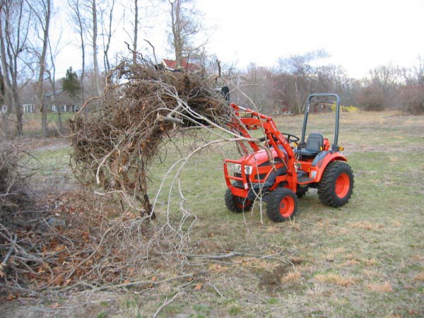

This was my biggest "bite". Note the shadow of the load is bigger than the tractor. Gotta teach this pup to take more polite bites in public as it is hard to see where you're going with all that stuff in front. FEL handled it fine however and it was not my heaviest load as it was mostly saplings intertwined with briar.

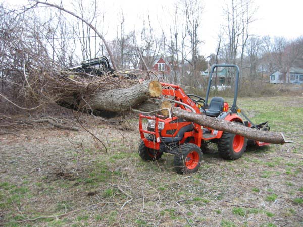

Approx. 10 inch tree cut in thirds. One gulp. No problemo for either the grapple or tractor. Go little fella, go. Who says you need more than 21hp to do serious work????

Oh man I like it! You don't say how much it cost though. Do you mind telling? No Prob if you don't want to say. Or I missed it. I can do that easily after as little sleep as I've had these last several days!
You put it on yourself? How much hassle was it?
Be very careful about where you put those ties, and watch those hoses. I had mine zip-tied, but somehow, they loosened enough and one of the hoses worked loose enough for something beneath to catch it and pull it right off and started wrapping in the tire. Try not to tie them to the metal hydro lines as this could tear them out good if what happed to mine happens to yours!
That weight is pretty darn good. You don't lose all that much lift as it is similar to the reg. bucket + a little.
Thanks for the posting.
John
you posted a couple more while I was typing my first part of this. Love your house, very picturesque.
When I first saw the pic of the trunks in the bucket, optical illusion made it look like you'd dropped on on the hood. I looked thrice though and saw I was seeing things!

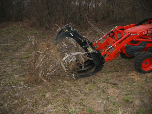

This was the root/stump that was too big to lift. It wasn't at all hard to grapple and push or skid to its final resting place however. Skidding with the grapple seemed to cause much less damage to the turf than if I had dragged it with a chain. Just left the deep impressions rather than tearing up the ground.
