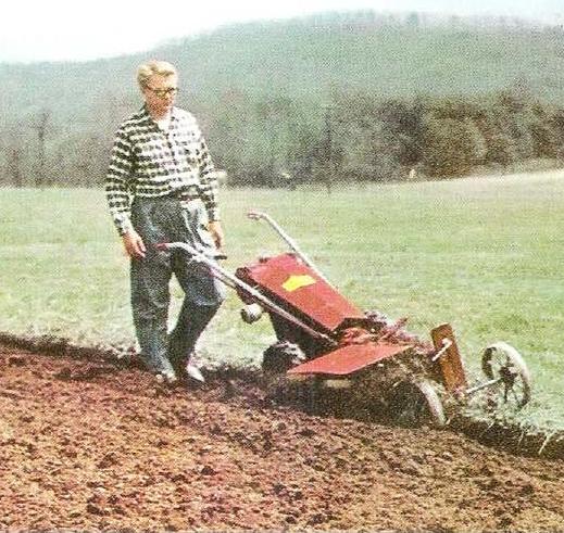

The rotary plow is a implement like no other. It takes some fiddling to get it to plow correctly. You will know when you have things set right when it just cuts a straight furrow without any help from the operator as shown below.

- Let the tractor do the work. Once you get it set up, all you need to do is to be there to stop it if it hits a rock, etc. See picture below.
Note the offset of the front wheels.
