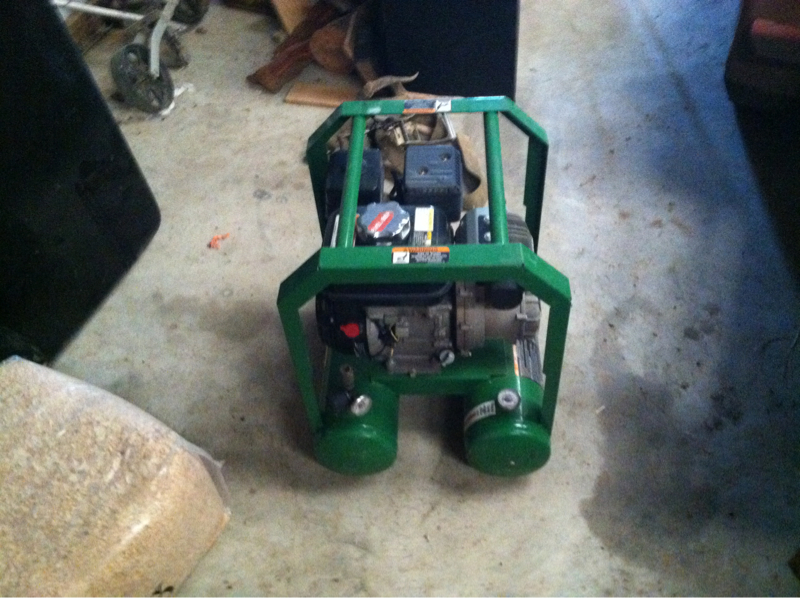

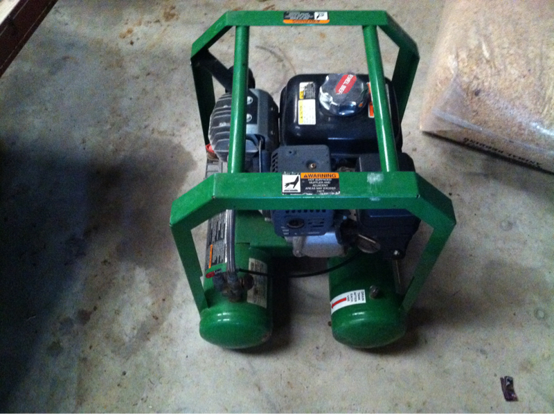

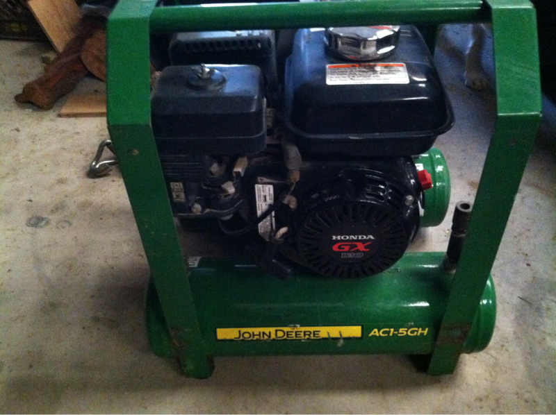

This is the solution I come up with for a similar problem. I have never had much luck with inverters. Local John Deere dealer keeps these in stock . I can easily move it from around, it will run a 1/2" impact and air up tires all day. A tank gas last a long time also, lol. LUTT

That is really nice!
   / what can i run with a power inverter? #9
Thanks, I didn't need a full size gas compressor, they take up touch room in the back of a shortbed pickup!. Also northern tool sells something similar, or used to. LUTT
