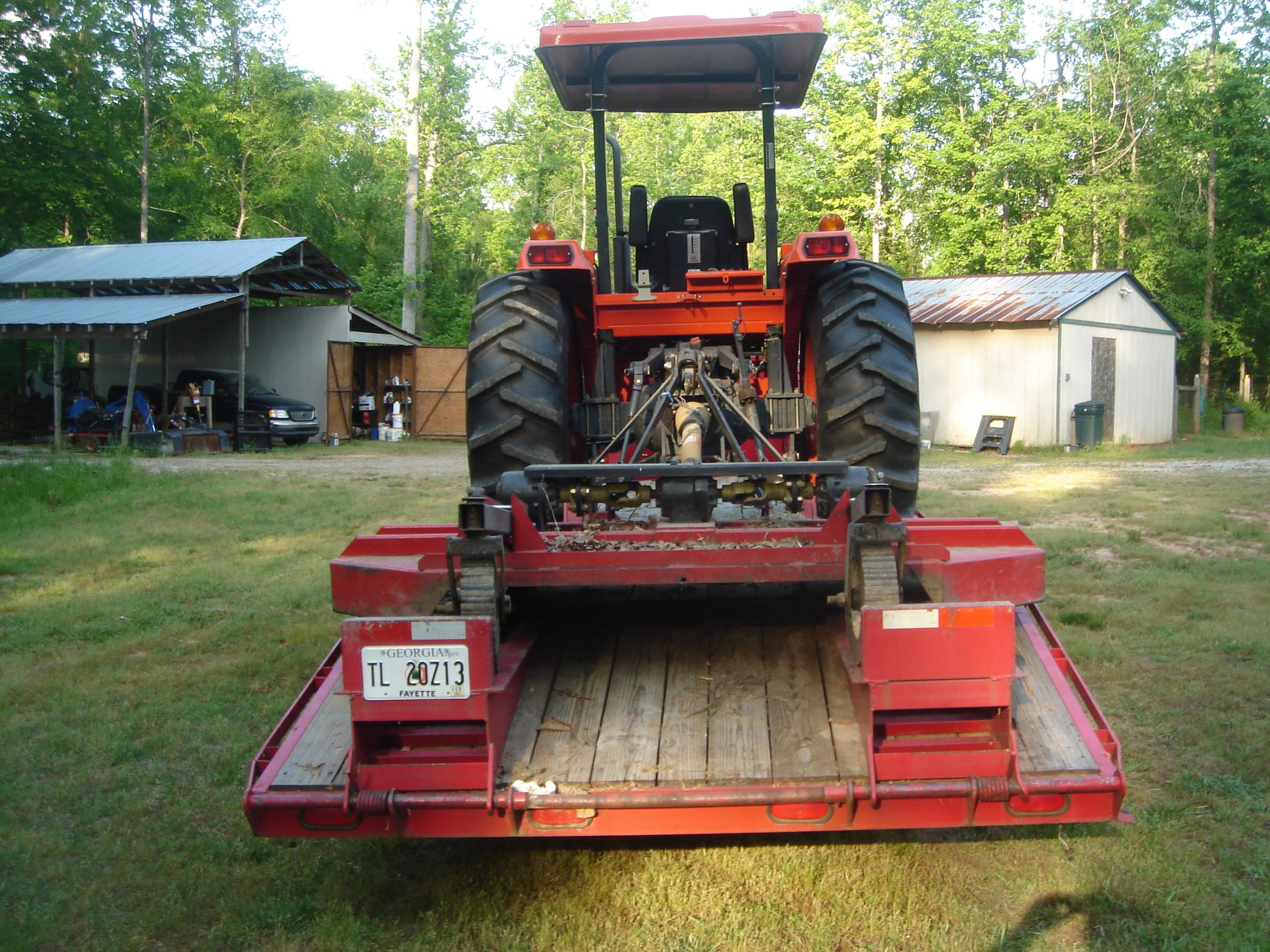

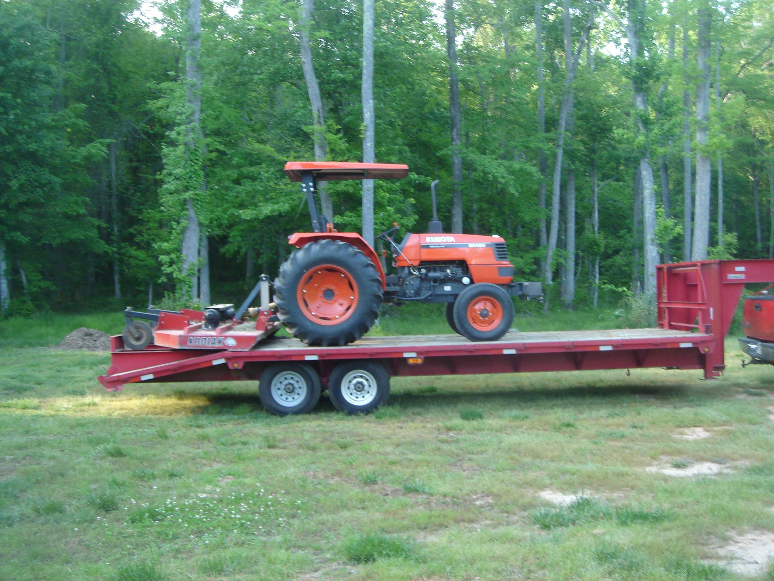

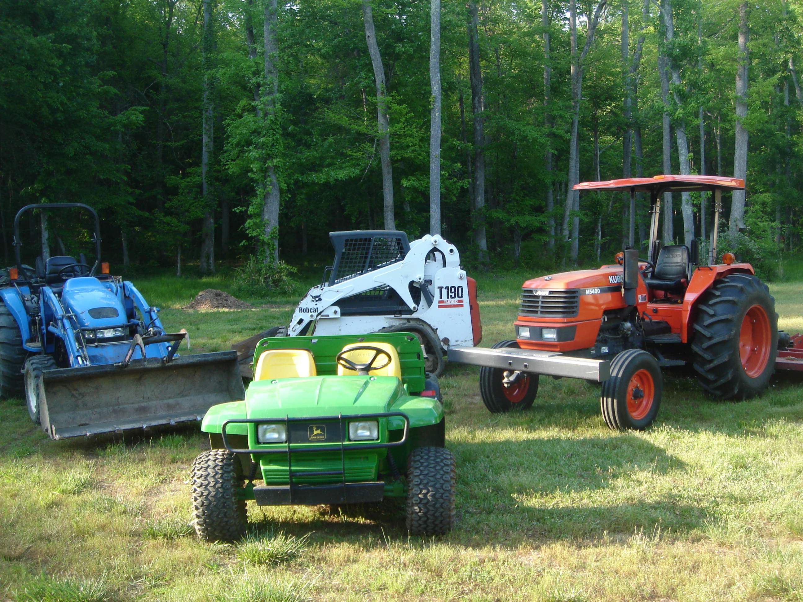

I have a small landscaping company on the side, I mostly do bush hogging and pasture work. I currently use a Kubota M5400 58 Engine HP / 50 PTO HP for my bush hogging tractor. I have used about every brand name and configuration of rotary cutter ( aka bush hog ) on the market. With 90 acres you need something big. I would look into something like a Bush Hog legend 2615L, this is a 15 ft batwing mower. Your 7040 will have plenty of power to run it. You also mention you may need to transport it. If so you need to keep in mind the widest thing you can transport without a special permit is 8 ft 6 inches. So that limits you to a 8 ft model. Unless you go with a batwing type mower. I don't like the 7 ft cutters because they are a single spindle. They are very long and heavy, and eat up the horse power. A dual spindle 8 ft is lighter and uses less horsepower than a single spindle 7 footer. The 8 ft will also give you a cleaner cut. Pull type mowers are great for wide open areas, but are difficult to get on and off a trailer in a timely manner. So again if this is something you are going to transport I would stay with a 3 pt. lift type.
As far as brands go I like "Bush Hog", "Brown" , and "Kodiak". "Landpride" and "Woods" are OK, nothing bad to say about them. I had a "Rhino" that was very disappointing, I'll never have another one.
I currently use a 8 ft twin spindle Kodiak behind my M5400. I'm very pleased with it. Cuts well, heavy enough for the abuse, but not to heavy to move around easily. It's actually 8 ft 4.5 inches wide when you count the skids.
Maybe "farmwithjunk" will jump in on this, he does commercial mowing and has a wealth of info. on the subject.
BTW, there is a M7040 on my local "craigslist" with cab and "AIR CONDITIONING" that I have been drooling over. Or I should say "sweating" over.
