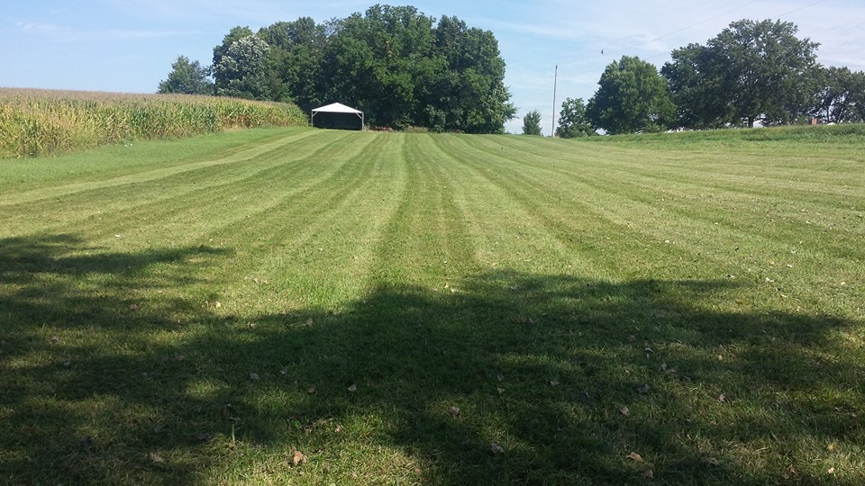

Just a quick update here. I went with the G6 blades after reading a lot of commercial mowing guys really like them and they are supposed to last as good as anything. I like how they do mulch the grass some, we mow a lot of stuff that might get 8-12" tall between mowing and with the stock blades regardless of how many times you went over it I could never get the clippings chopped up as much as I wanted, with the Gators hit those clippings as second time after they've dried and they turn to dust. The downside to the Gators is they leave some standing grass unless you slow way down, at 4 mph they cut just as good as the stock blades but at 8 mph the stock blades do a much better job. The grass (just part of an old crp field) was 8"+ tall when I mowed it with the Gators and as you can see there's not much for clippings. I think I'm going to finish the year with the Gators since tree leaves will start falling soon but I think I'll get a set of new Kubota blades for spring and switch back to the Gators for mowing tall stuff.

looks good. I installed the G6's after 2 years on my mower and have been moderately happy. I think you nailed it about slowing down. I find they also don't do as good a job on damp grass (early dew) as stock blades.

Most of our customers run the factory blades all year do to the fact of them holding an edge better(not all is created equal) and they switch to the gator blades for leaves only. Time is money for working people!
