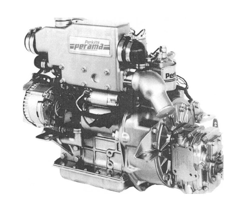

Solenoid is separate. Battery is brand new and cranks my 4WD over just fine so it should be OK. When I touch power directly to the starter it spins OK so I hope thats OK too. So hopefully the problem is just my cables. I'm just using 2 pairs of quite heavy jumper leads at the moment. I doubled them up to run parallel, so I had 2 clamps to earths and 2 clamps to a flat bar bolted to the solenoid terminal, plus they were separately clamped to large bolt on battery terminals. I thought this would give me sufficient contact to happily turn over this quite small engine for a 'bench test' but perhaps not. I'll have to get some proper bolt on cables. It looks like my problem is stupidly self inflicted. My original question of whether the battery is big enough seems to have been answered. Thanks gentlemen.
The pic attached is from the manual. Its actually a marine engine.

Yep, the clamps are the problem. I would expect 3-400 amp initial draw and no start cranking draw of 200-275 amps, maybe more on that new old diesel. Hard to get that much current through the small contact area of jumper cable clamps.
