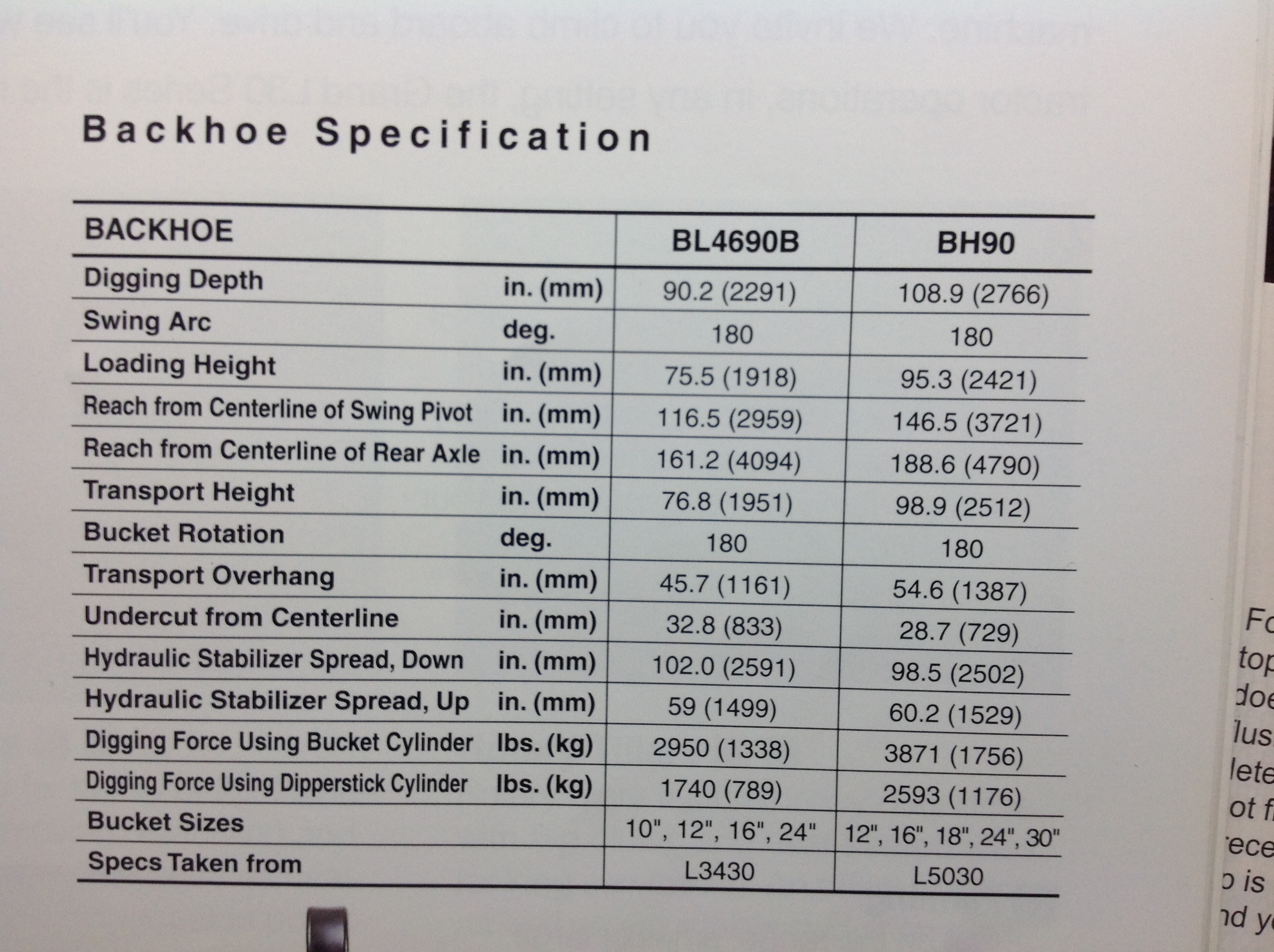

I found all daddy's papers on his tractor. Now I know what fits his tractor. IMG_1666.JPGIMG_1667.JPG
