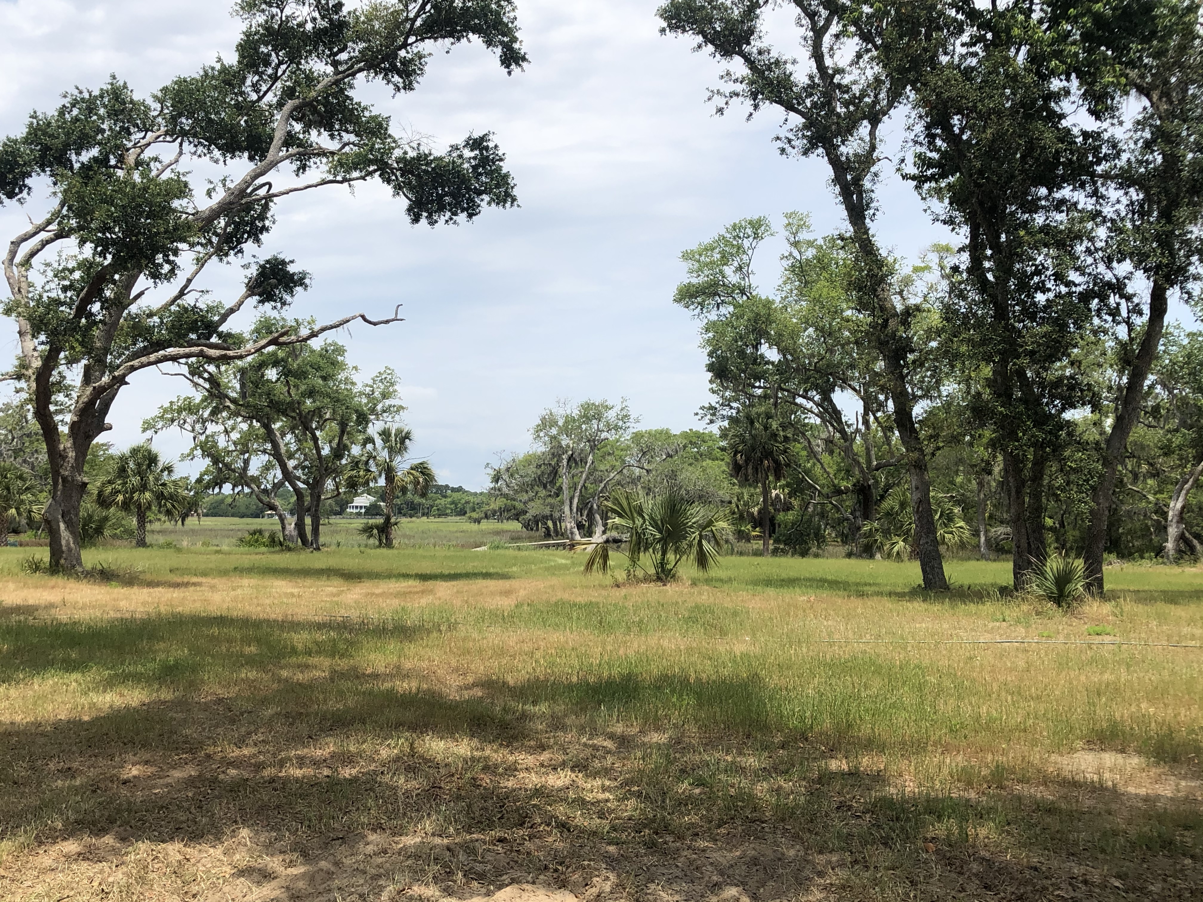

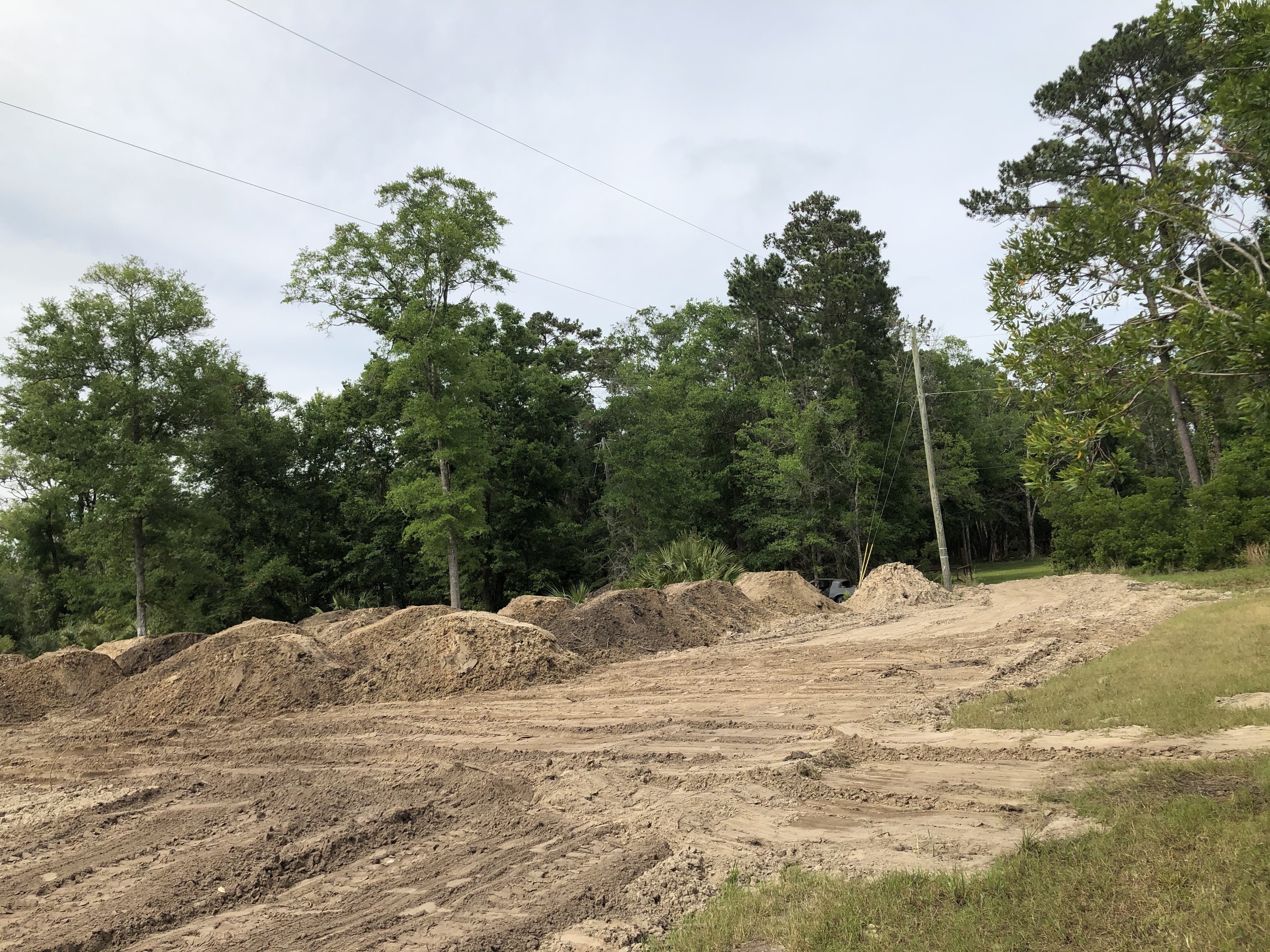

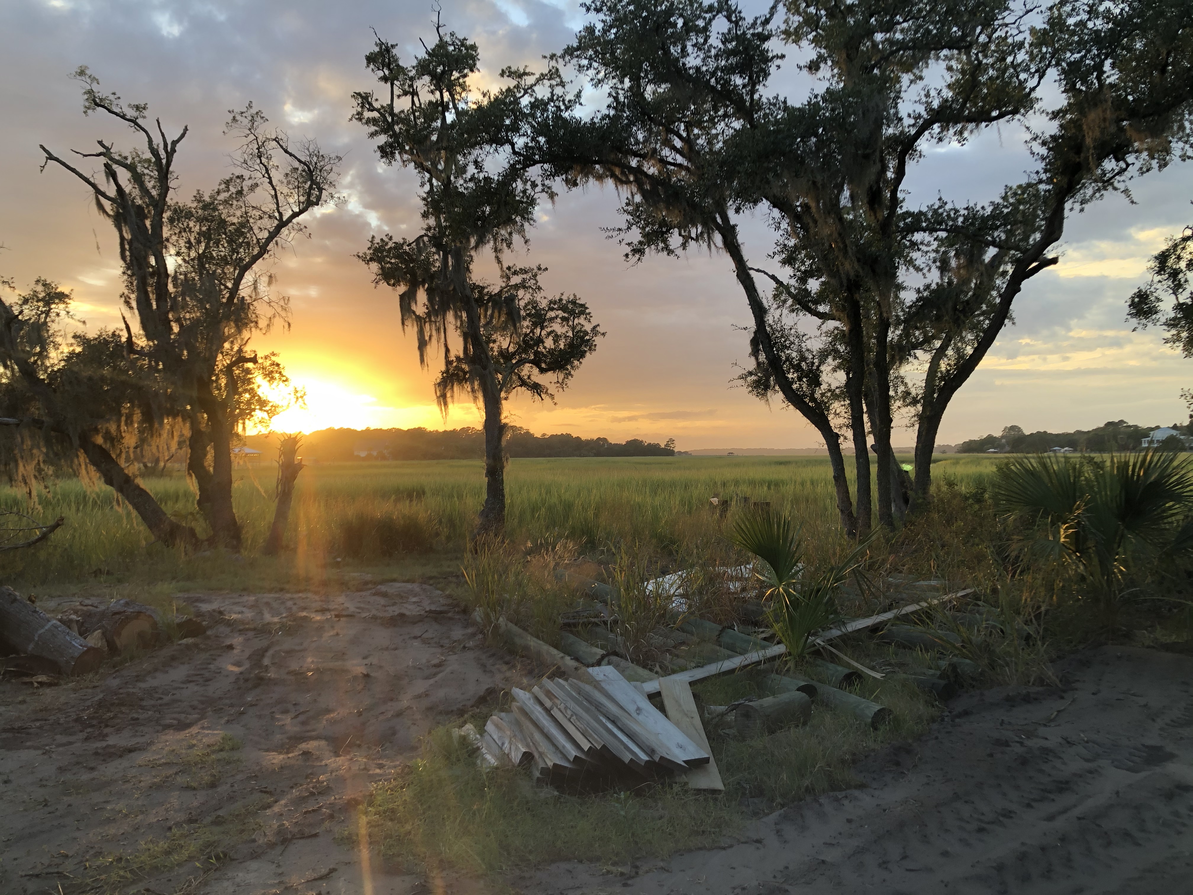

   / What attachments would you use for this job..
Few photos of some some of the stuff still being finished. It has come a LONG way from where it started years back. Now it just needs a little topsoil and to fil in any low spots while cutting high spots so it will be be very yard like.

   / What attachments would you use for this job.. #8
Thanks for the photos, and they do help to visualize your challenge. Spread the delivered fill as much as possible with FEL and box blade. Average 2-4" fill everywhere you need to level. Then make your own custom drag mat 5' x 8' out of a single welded wire fence from any supply store, including tractor supply. Just work this drag mat back and forth for hours, using either your tractor, a ZeroTurn or an ATV vehicle. You will get very experienced at this. Eventually you will find, that even bringing in fill dirt may not always be necessary, and just dragging the box blade with rippers down to loosen the soil is enough provide you with material for your drag mat.
   / What attachments would you use for this job.. #9
Is the last picture with grass the most recent condition of the property?
If yes how soon before you begin construction?
The process of construction will most likely mean any smoothing leveling you will do now will need to be redone after completed. Think delivery of materials by truck, works trucks parked on damp soil, some type of lift to set trusses on wet soil, footings being dug and that soil put on piles.
It is hard to tell in pictures, but it looks plenty smooth enough to mow, perhaps with a rough cut mower at present. Then after construction is completed, evaluate your needs again. If plans include a very long (50*’) gravel drive way, I would highly recommend a land plane implement with scarifiers as a needed tool. It will move gravel/dirt, but less so than a box blade as it is a very low frame designed to allow material to spill out. Once your grass has established good roots, you will need to break up those roots to soil, but you will also need to break up ruts from trucks and equipment during construction so scarifiers are a must in my opinion
