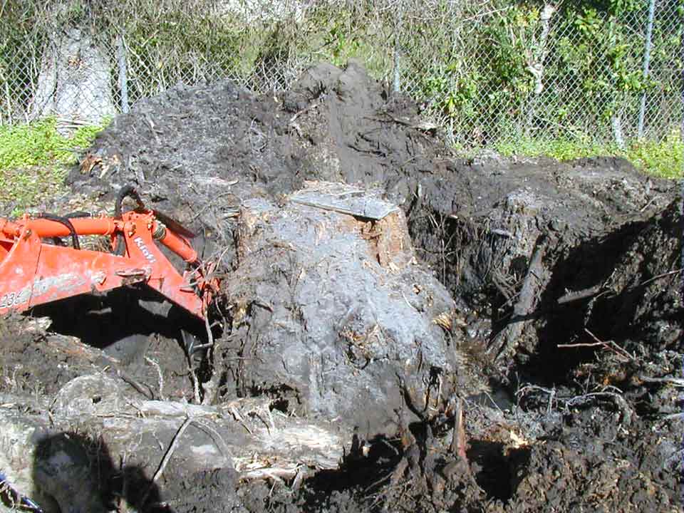

A backhoe is not a necessity, but I'm sure glad I bought mine with my tractor ($4300) and FEL.
When you buy a tractor, get a toothbar for the loader to break up those piles, and to help you dig and load debris into the loader better. A toothbar is indispensible in my estimate, and will help you remove the berries and small saplings etc. Also, a boxblade will help you drag the soil around and level it. Make sure you get one with rippers so that after you get the pile down some, you can use the boxblade to move the rest.
My CK20HST is about equal to the Kubota B7510, only a lot heavier and I like that for extra traction. The whole package, including 54" FEL, 6.5' BH, 48" boxblade and tractor was $16,681 + FL tax in Jan 2004.
There are a host of other implements you may want/need, like a brush mower, finish mower, landscape rake, boom pole and on and on, but that's for another post I guess. Welcome to TBN. John
The attachment is a stump I dug out with the BH. Above ground was about 3' diameter. Just below the surface, was > 5'. Took many hours, but I got the sucker. John
