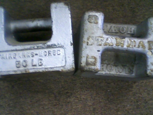

Can anyone please identify what these weights are used for?
Thanks in advance.

Yeah work has a set for calibrating a pavement friction drag. It mostly is used to hold a door open lol.
/ What are these weights? #4
From what I see they look like the weights the company that services the elevators at work use for testing elevator car maximum load capacity. I'm sure there are probably many other uses for similar weights.
/ What are these weights? #5
they are dumbbell weights for fairbanks scales
/ What are these weights? #6
The Fairbanks one I think was used on a scale arm. Hard to tell on the other one, how much does the first one weigh? I know it said 50 lbs on the weight, but does it really weigh that?
/ What are these weights? #7
I've seen those used in grain elevators to certify the scales. The Federales (Measurement Canada up here, eh) show up with a truckload of them and start piling them on the scale various amounts at a time and then "weigh" them. The beam scale should agree with the know weight on the scale pad...plus or minus the allowable error percentage.
/ What are these weights? #8
thats what i've seen them used for
/ What are these weights? #9
Yep, thats what I have seen, the exact same weights used by the elevator guy to certify the elevator. I suppose they could be used for any purpose to certify any scale or whatever.
James K0UA
/ What are these weights? #10
People said the word certify and certified right much. We call them "certified weights as work. We have some HEAVY ones too.
/ What are these weights? #11
They make things you put them on heavier
/ What are these weights? #12
Sometimes they are useful in product testing for example hang them from a simply supported beam and measure deflection to test bending stiffness (flexural rigidity).

This board is a veritable fount of knowledge. Thanks for all the feedback. My brother bought them from a used fitness equipment store of all places. We'll probably use them for their pavement friction drag when they're not making things heavier.
