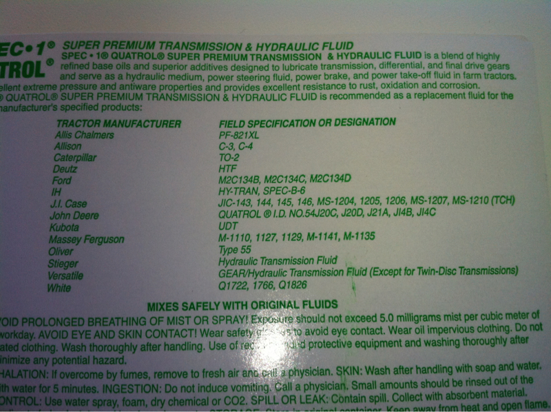

Here is a pic of a bottle of LS branded hydraulic oil with the listing.

I'm using Kubota UDT

I just use TSC universal hydraulic oil. My dealer said any good quality hydraulic oil that is rated for wet breaks, so that is what I use.
   / What are popular hydraulic oil brands for R series owners #7
I have even used the NAPA 15/40 and the TSC 15/40 bothj fleet oil.
   / What are popular hydraulic oil brands for R series owners #8
My factory service Rep , says any good 303 tractor fluid , personally I use Shell Rotella HD , meets all the specifications
