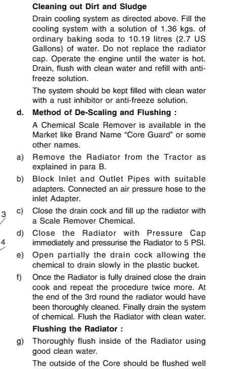

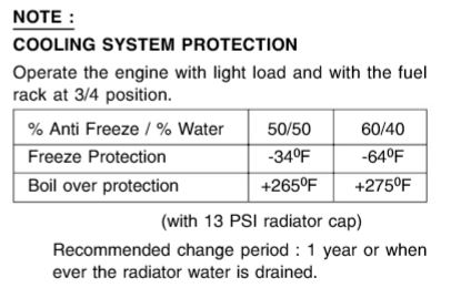

I ATTACHED ALL THE COOLING INFO I COULD FIND, I KNOW IN ALL OTHER TRACTORS I HAVE LOOKED UP ITS E.G COOLANT (GREEN) :)

Use Tractor supply "Fleet Guard". It has the SCA pre-charge in it. Silicone control is needed in diesel engines. Regular antifreeze will work but is not the best in the long run. You only change this out every couple of years so it does not make sense to just buy the generic antifreeze to save $15 or$20 bucks.

Make very, very sure what you are putting in is exactly right for your tractor!!!! There are several types of engines mahindra has used. The most sensitive will be the mRCDE engines in the 40 and 50 hP tier 4 engines. This engine cannot use the old green at all. It has silicates for corrosion protection. Silicates will pull pinholes in a wet sleeve engine. Silicates will precipitate and glaze (insulate) the surfaces on the egr cooler, which will send it into permanent limp mode requiring replacement egr cooler and egr radiator etc... HOAT comes in different types. It may be greenish, yellow orange and maybe even blue. Besides the different colors, some use phosphates, nitrates or other chemicals in addition to the organic acid agents which themselves come in different formulas. Some organic acids (especially the three that are in DexCool{Pink}) will destroy plastic or silicone components of gaskets if not compatible.
So, be very careful not to use the wrong one. The wrong choice (consider too that your dealer might not even use the right one if he sells different brands and only uses one coolant for all brands of tractors and brands of engines found within brands of tractors) could require a complete engine rebuild in a short time. The shock wave(bang) on the cylinder sleves causes silicates (WHICH IS IN ALL TAP WATER TOO) and phosphates that stuck to the out side of the sleeve to vibrate at a force which will propel the scale off. Sounds great, but it pulls metal with it and makes pits that go all the way through the wall in no time!
So, If they require HOAT, not all hoat's are safe. If they require OAT, not all OAT's are safe. Ask many questions and don't just depend on the counter guy who says "this one is universal".
