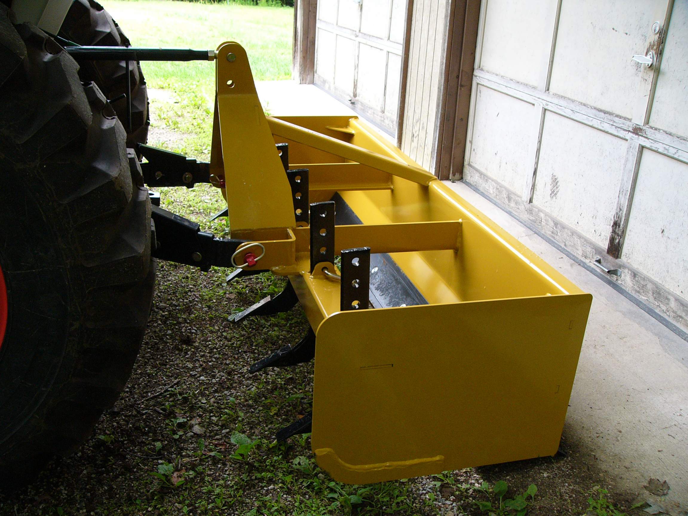

Everyone says the King Kutter is too light and talks nonstop about box blade weight. The KK is only 500 lbs and has worked perfectly fine for me. It's 25 lbs more than the EA box blade, well built and I paid under $600 for it new. Sells now for $620.
I've dug a ton of my TOUGH clay soil up with it, have it constantly loaded, and spread out 550 yards of topsoil in about 2 days of part-time work.
I'd go with the KK and save the money difference for more attachments. I have a bunch of KK attachments, and the only thing I have been disappointed with was the 7' rear blade but it was an el cheap at $379 new and behind a 40hp tractor. There were a couple welds I had to reinforce after hitting some iron stakes in the driveway.
