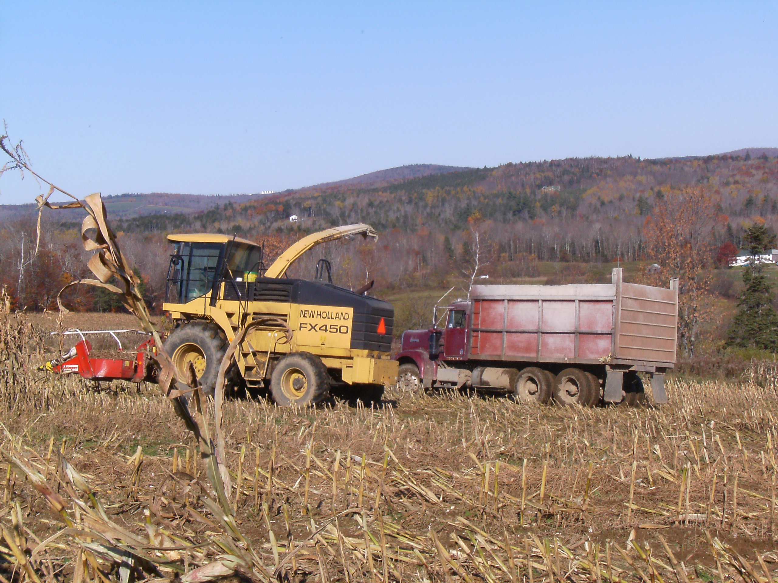

For us it has always been plowing that is the limiting operation since every other operation after plowing is on wheels, or at least rolls. The disc harrow, the planter, even the silage chopper and trucks all roll. But plowing...that is a 100% drag operation, and it requires a lot of momentum, in fact the faster you plow, the better the plowing that is done. That is hard to do when you are clawing for traction up a steep incline. And since soil only gets cast off to the right, a person cannot just plow when and where they wish; sometimes direction is dictated too you.
Mud can also be an issue. With plowing, it is the first operation as soon as you can get on the field, so it is often wet. That can be an issue with disking too, but not so much with planting and side dressing. It seems mud is always an issue with harvesting because we get a second mud season so to speak of, every fall, but the trucks can be dragged anywhere behind a tractor, and of course the chopper can go in anything.
We farm on some pretty steep hillsides, enough so you have to articulate the tractor to the uphill side on a turn because if you did so downhill, you would reduce the stance of the tractor and go over. (But to my credit, I have only rolled a tractor over once. Incidentally, it was while plowing).

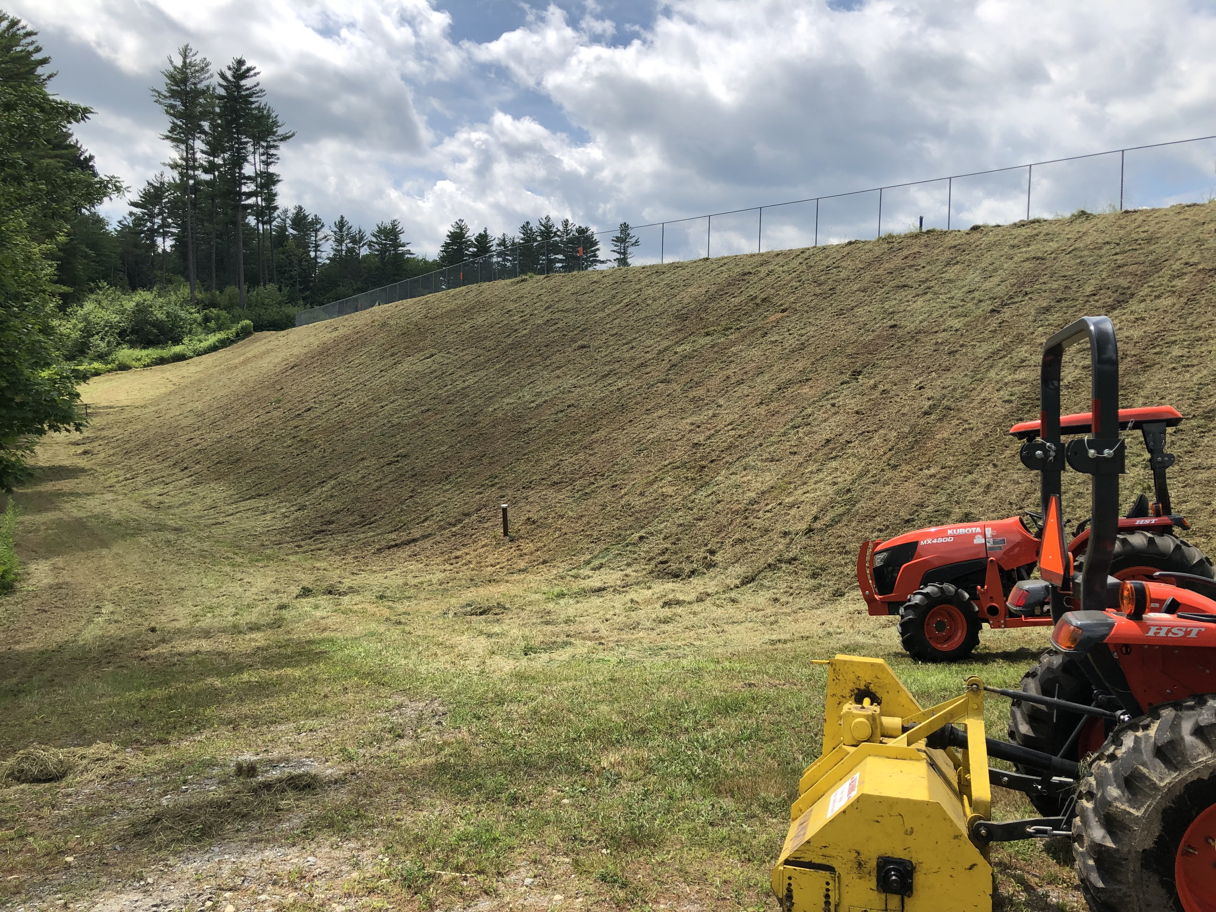

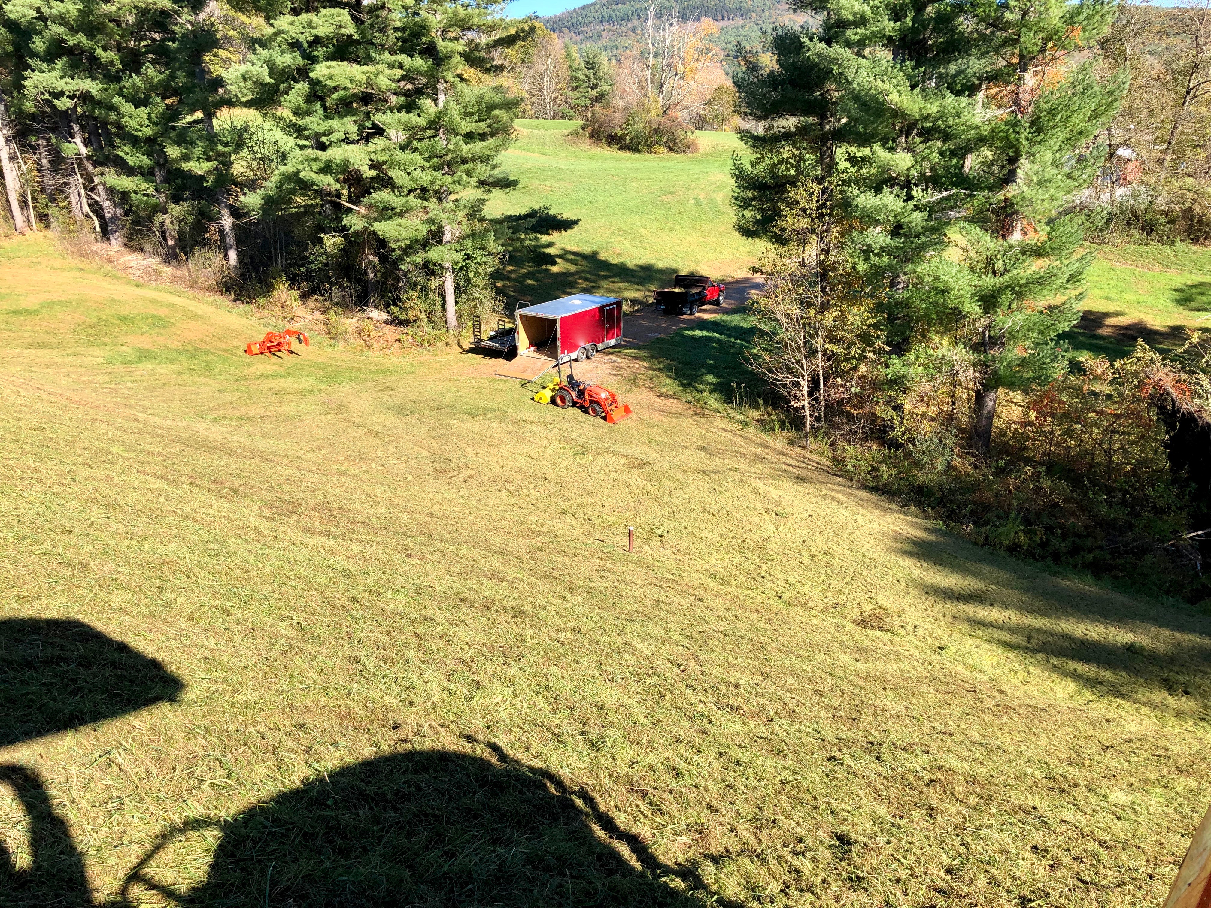

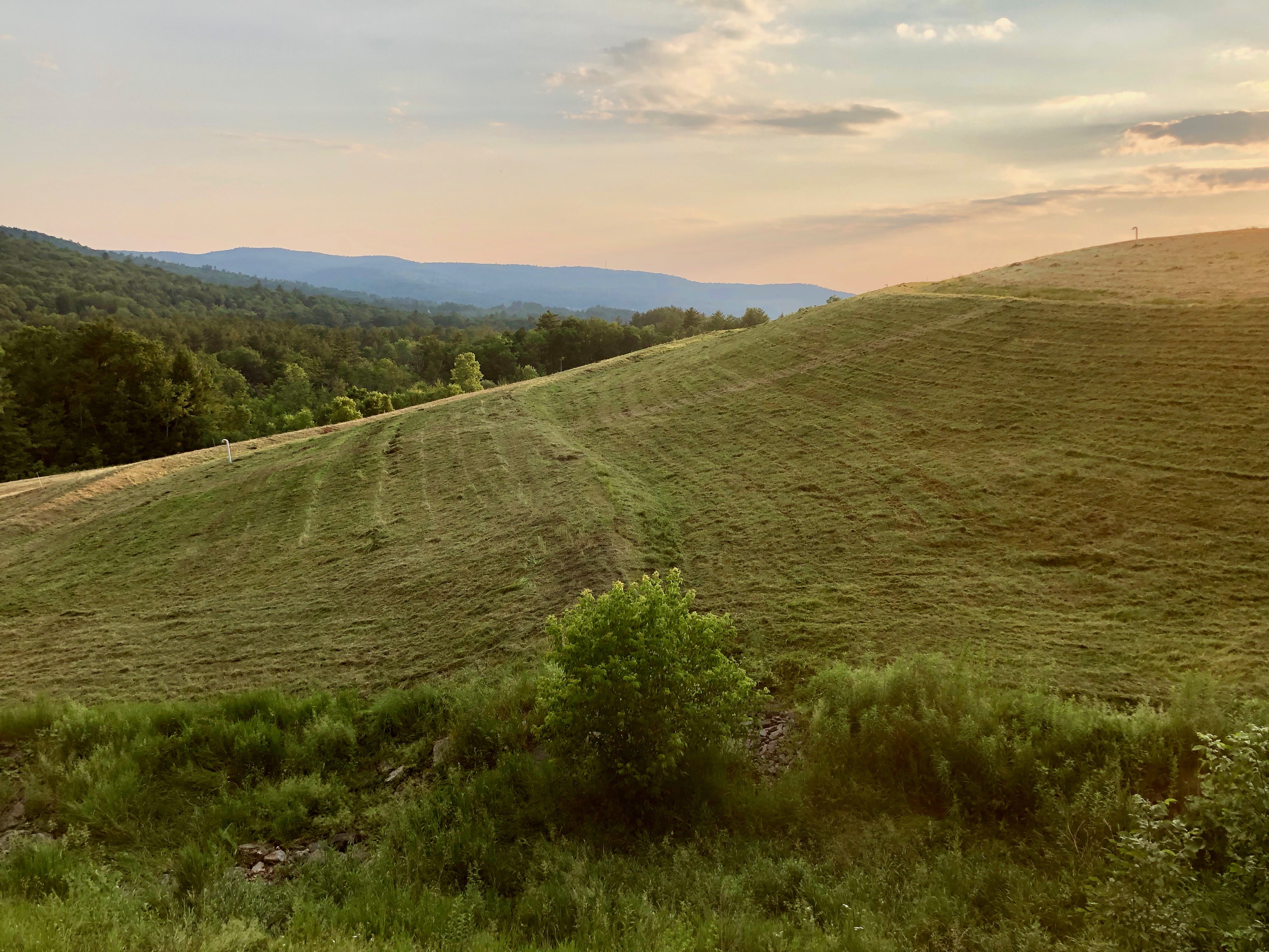

I don't plow, but I do flail mow some pretty steep stuff. IMG_4506.jpegIMG_5576.jpegIMG_5496.jpeg
