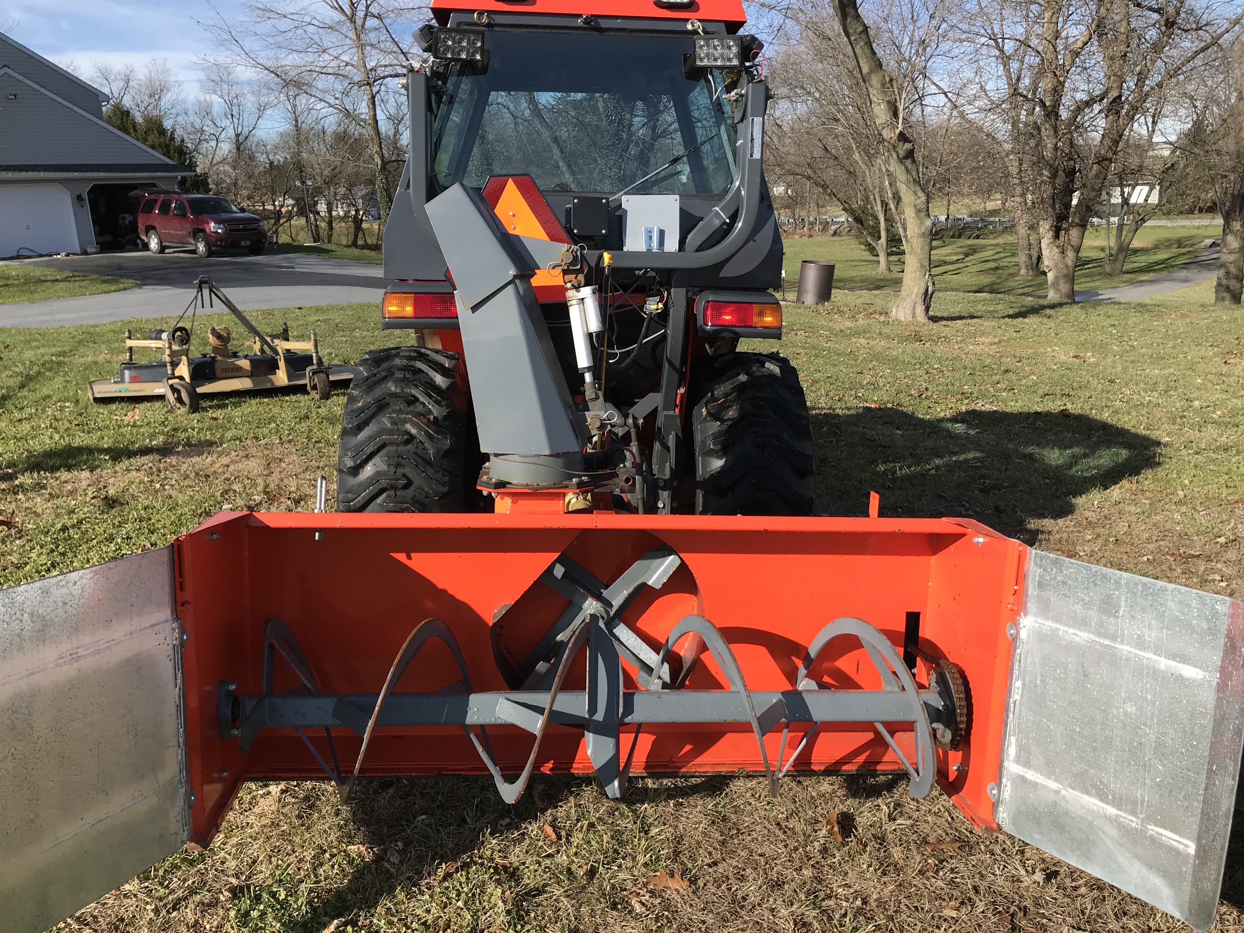

Here's a picture of the L3200 I recently sold. The blower was refurbed and painted 5 or 6 winters ago. The only place that shows much wear is in the fan box. I used Pittsburgh AUE two-part coating on it. It's DTM (Direct To Metal) and there were only a few color coats without primer. I forget the number but it was AUE 300/301 or something like that.
