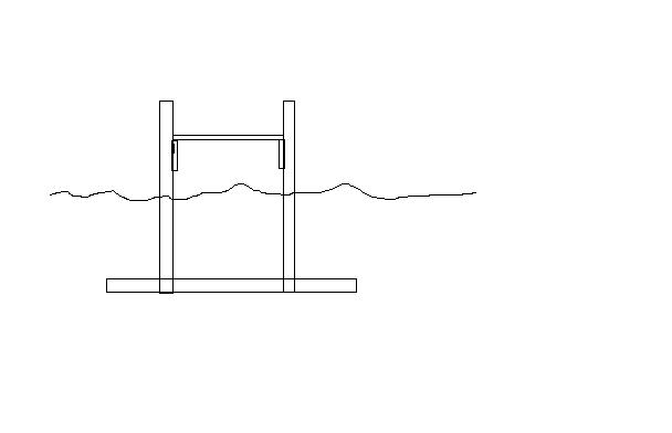

Need some ideas as how to build a raised walkway thru a bog I own. As far as the walkway itself, not a problem, that's nothing more than a narrow deck. But, how do I install posts into the ground and not have them settle excessively? /forums/images/graemlins/confused.gifI know the first thing to comeup will be to drive posts with my FEL, but thats a sure way to loose my tractor for all eternity /forums/images/graemlins/frown.gif. The ground is just too saturated to drive on. I'd like to build it similar to what you see in a lot of public nature areas, with an observation blind at the end of the walk. Probably close to 200 feet in length. Also wondering on dealing with the 3,000 or so special interst groups out there. /forums/images/graemlins/crazy.gif Anyone have experience in doing this?

I would think if it is as soft and deep as you say almost anything would settle over time.
You bee a wide foot print on the bottom of the post. Bell shaped conc maybe but the weight of the conc may make it sink faster. maybe you cound do something like in this stetch and keep you post long so you can adjust the dect as the post sinks

Chucko; I like that idea too! Appears to be a lot less fooling around with things too. But then again, the blue barrels are free. Free materials and more work, or pay for materials and less work. Well HUH, the scales haven't tipped yet. /forums/images/graemlins/smirk.gif
