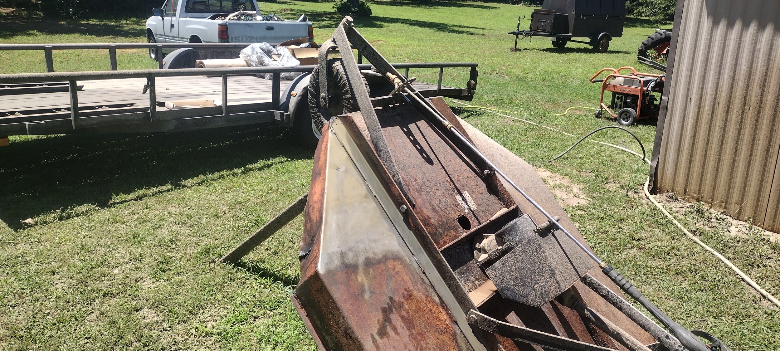

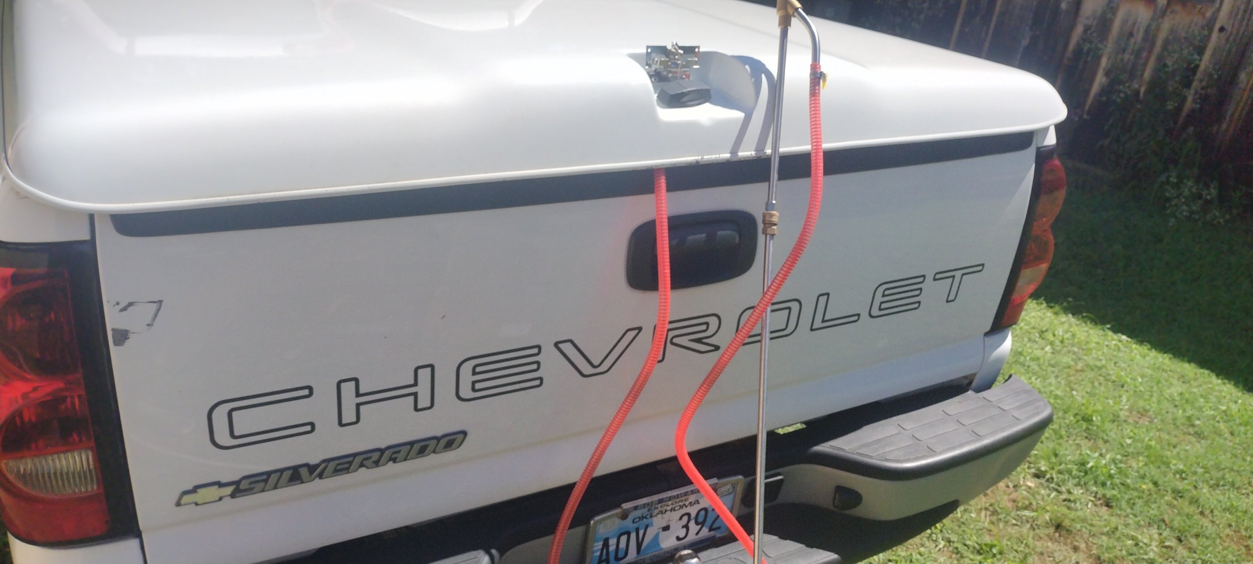

Wet sandblasting my brush hog with a 28.00 Amazon wet sandblaster. Wet sandblaster well worth the money. Will paint Kubota orange. Next project is to wet sandblast the smoker firebox surface rust on 3/8 " thick sheet iron and paint.
set sand in a bucket in back of truck, if sand gets wet it will clog the tube.
10 minutes of blasting left side only, and one 50 lb bag of sand. I figure 9 bags total 45.00 and an hour and a half labor.
Sand all over trailer and on 3300psi washer about 25 feet away.

I believe you are using a pressure washer that siphons the sand out of the bucket, the water keeps the temperature down on the metal, if I understand it correctly so less warp-age on thin sheet metal, plus you are not creating a dust storm.
   / Wet sandblasting
My Pressure washer adds 3,300 PSI to the mix, a lot more than air.

I have never been around a wet-blaster. It seams like the metal would start rusting as it dries. Is this possible, or am I way off base here?
   / Wet sandblasting
Mine has no rust after drying in hot sun
   / Wet sandblasting #9
EXACTLY and why I never do that, always dry and always Black Diamond.
You wet sandblast and surface rust immediately starts forming. Not something I'm interested in one bit.
   / Wet sandblasting
I'm doing a brush hog and there is no rust.
