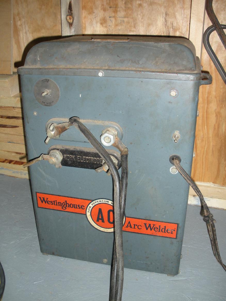

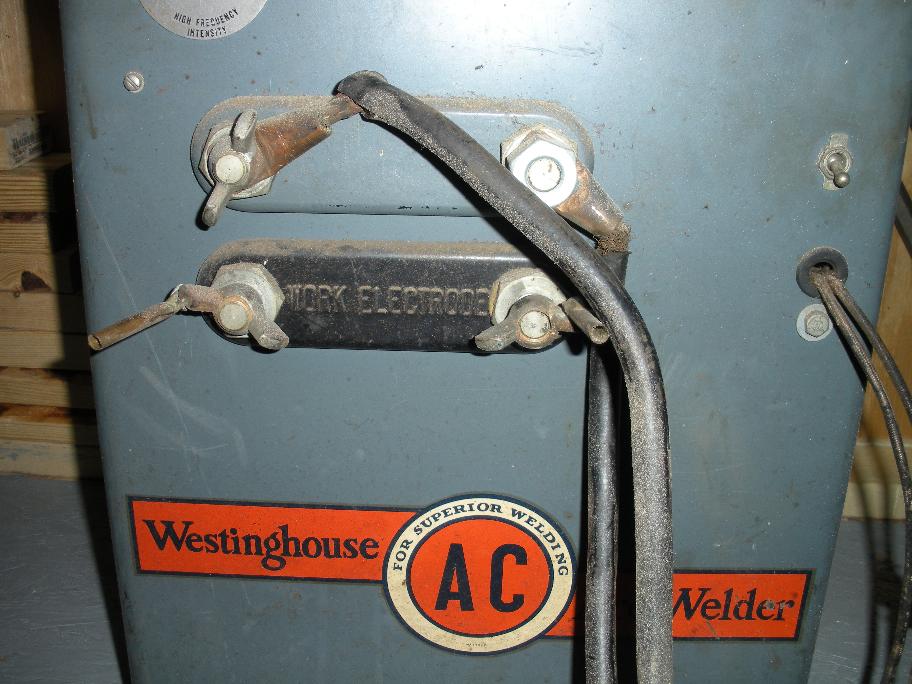

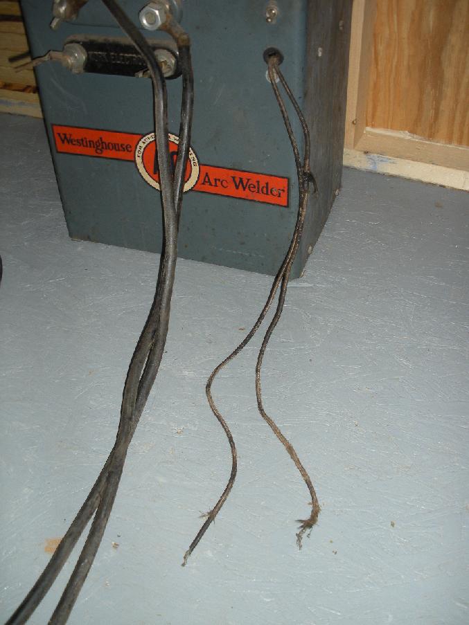

I question about A Westinghouse welder that I acquired from my uncles estate. My uncle had this welder connected to a Miller Econo-Twin and used it to TIG weld. I am not going to use it this way but I can't figure out the wire connections on it. It has two small wires that were not connected to anything (see attached picture). I'm not sure what they connect to (it is 220v so I don't thing they are for power). There is no other wires to plug in for power. Any help would be greatly appreciated.

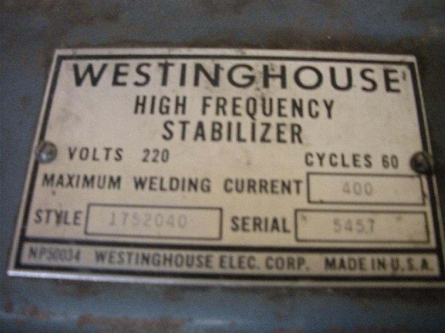

I could be wrong, but I do not think that that is a welder. It looks like it is an add on high frequency box, that you would use to TIG with a stick welder.
The 2 wires could be power as it probably doesn't draw a lot of power.
The best thing would be to take a cover off, and post a picture of what is inside.
