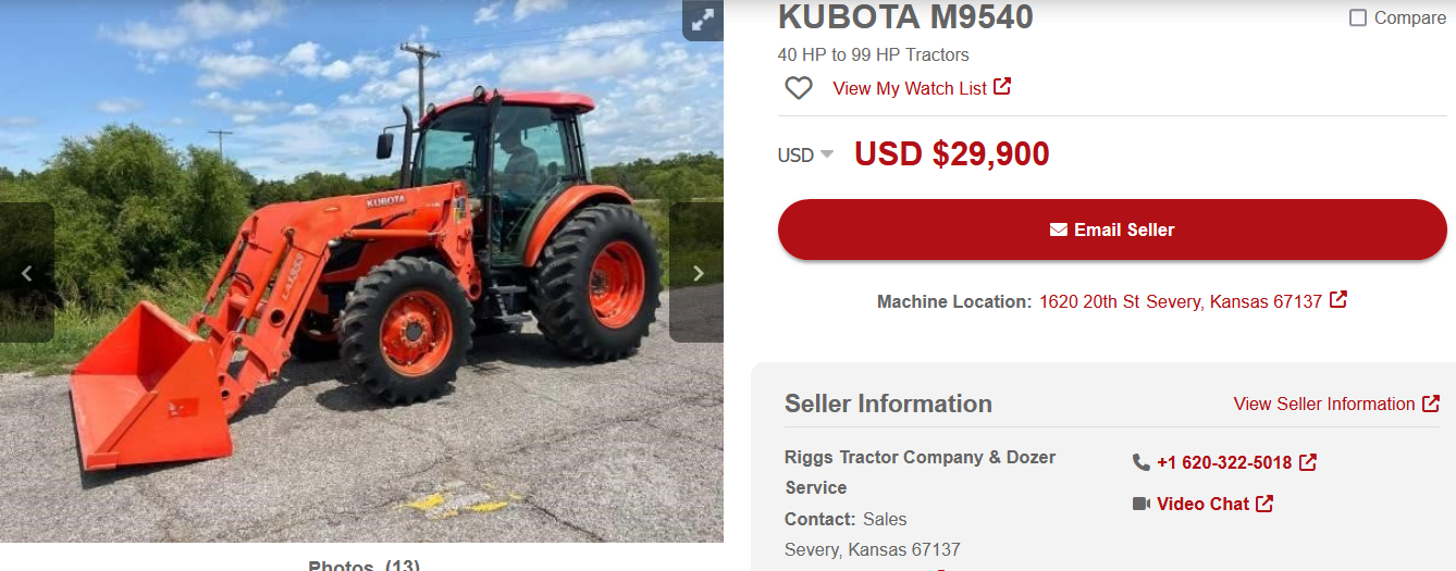

It's counterintuitive, but sometimes bigger Utility Tractors are cheaper than a smaller Compact Utility Tractor. A Kubota M9540 for example ...
