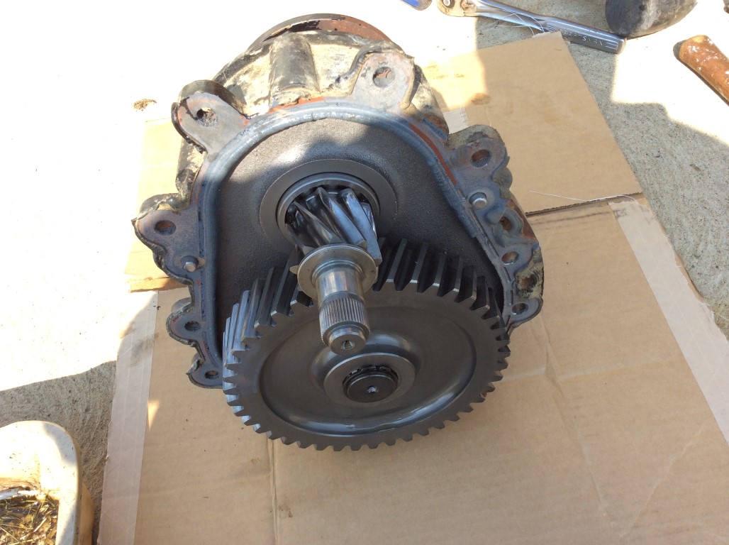

So I got the front axle fixed, and the tachometer fixed, only to discover I now have a rear axle oil seal leak.
As my tractor was waiting for parts, I thought it was rain water by the rear wheel, I didn't think twice about it as it's been raining..come to find out the drivers side rear axle is leaking.
This one is my fault though, I was brush hogging a few weeks back very high grass, and it wound up on the axle, so much so that it got under the oil seal and trashed it.
So now ordering part # 721-0495 and preparing to replace it.
I had to drain the oil as it was dripping pretty bad.
I'll document the fix.
Well I ordered the new seal, and looked at the repair manual for the 7000 and 5000 series, and it looks like a rather simple fix, we'll see
   / Wen it rains it pours.. 721-0495 oil seal needs replaced.
#2
Well, the shaft and bearing is not coming out. I even made a make shift puller, and was getting on it pretty hard, it didnt even move.
So this leads me to believe that there is a retaining clip on the inside of the axle, and the housing must be taken apart to get to it.
My 7000 manual doesn't even show the rear axle, does yours? The one I have for the 5000 shows it to be as easy as removing the oil seal, and retaining clip on the outside, then it is suppose to
slide out.

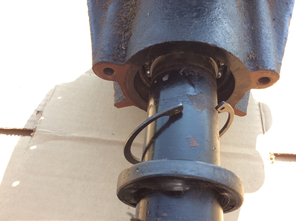

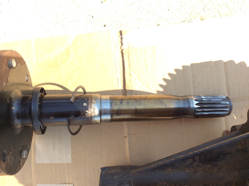

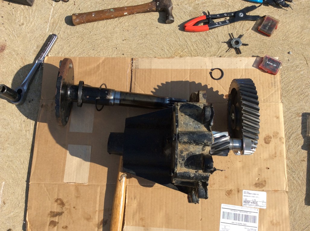

I'll get there scout.
It was just as I suspected, a retaining ring on the inside.
Here are some pics.
Getting ready to seal it back up soon.
Got it all put back together and fluids in, and took her for a 1 hour session , so far no leaks!!!
It sat overnight, no leaks!
So here is the procedure.
remove tire
drain fluid.
Remove 3 bolts holding the 3pt at the axle housing
remove brake rod from axle housing by removing clip and sliding off, then tie this out of the way so you can remove axle housing.
remove 2 bolts that hold diff lock to housing.
remove 12 bolts (16mm) that hold axle housing. (be very careful as the housing is very heavy and will start to come off when all bolts removed)
carefully remove axle housing with axle inside. place on clean surface
Remove oil seal, and then remove large retaining ring on the outside (note you can also do this step while still on tractor)
remove inside clip, be careful as the gear will come off when you slide the axle out)
slide out axle.
take off old seal, slide on new seal.
reverse process to re-install.
Makes sure you clean the old sealant off very good on both surfaces before reapplying new sealant. I went with permatex black , had high oil resistance.
As I think about this more, I don't believe you would have to remove the larger outside retaining clip at all, as the axle should just slide out, I think that clip is to hold the bearing in, which unless you aren't changing the bearing, why bother. It will save you a huge hassle if you don't have to remove that outside clip.
