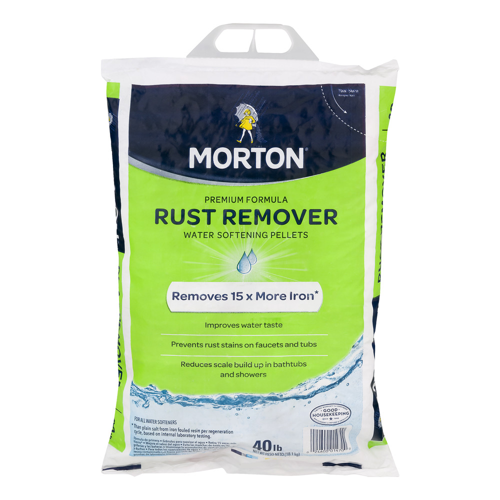

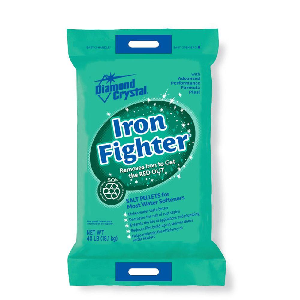

Any ideas on how to get not orange water that tested 15 iron and 22 hardness? My new water softener is at 70. We're still a tinge orange.
   / Well, well, well! #8
At my place, we use a spin down particulate filter, an air eductor system and iron reducing salt in the softener's brine tank. If it's just a 'tinge' then an eductor should be enough, if it was considerable, I would recommend an iron handler (remover). We have used these brands and all seem to work well...see what I did there?
