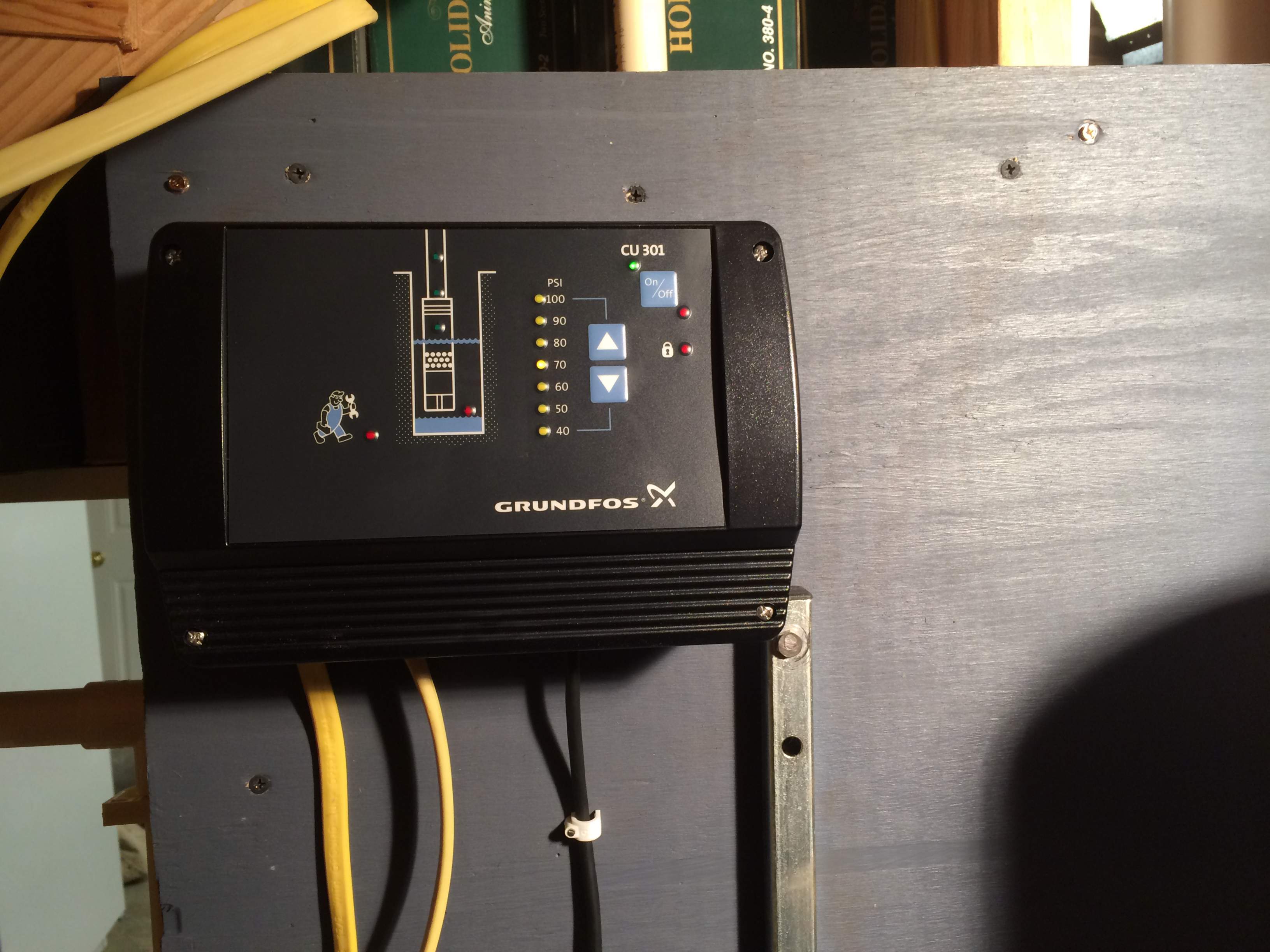

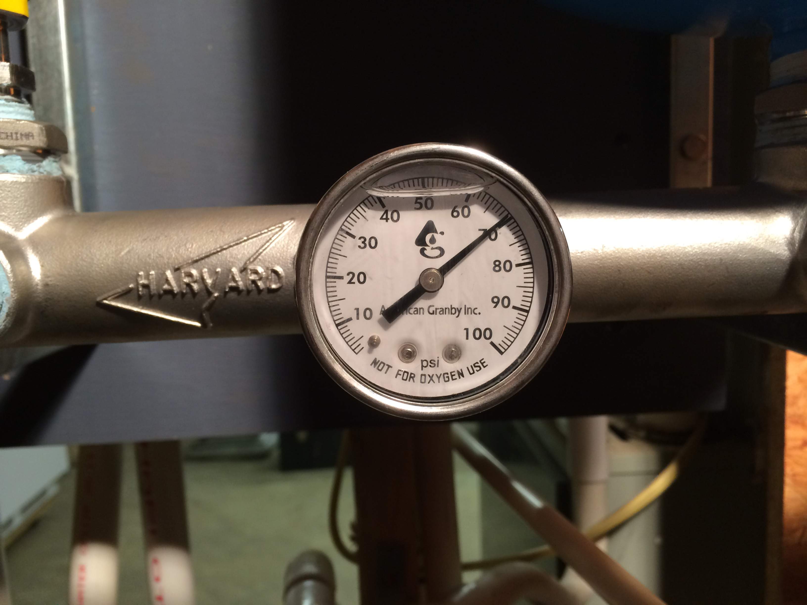

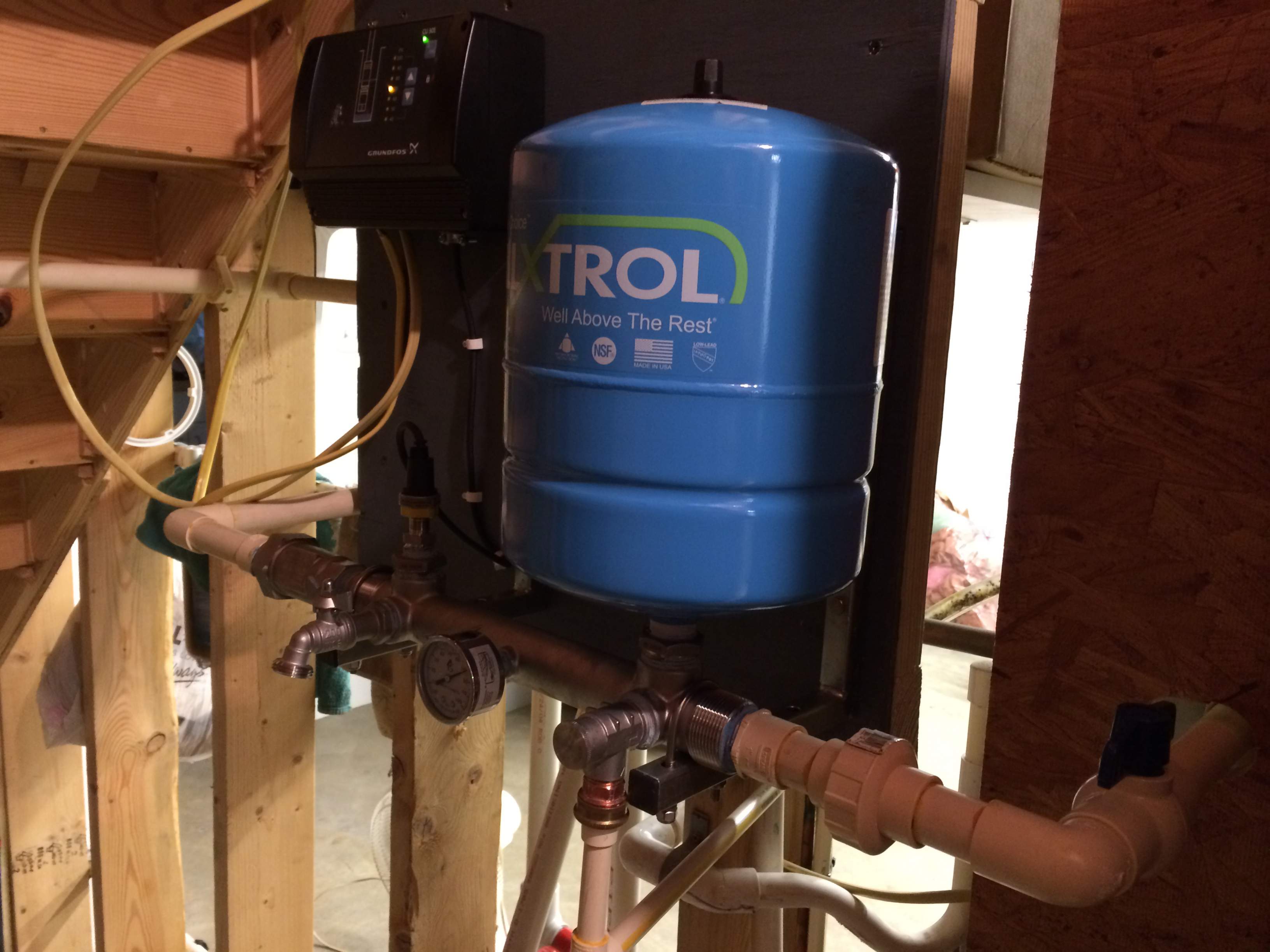

I installed a Grundfos SQE system a few month ago, I am extremely happy with it. I gained a bunch of space under my basement steps also since the system is so small.
Constant Pressure Pump | Grundfos
