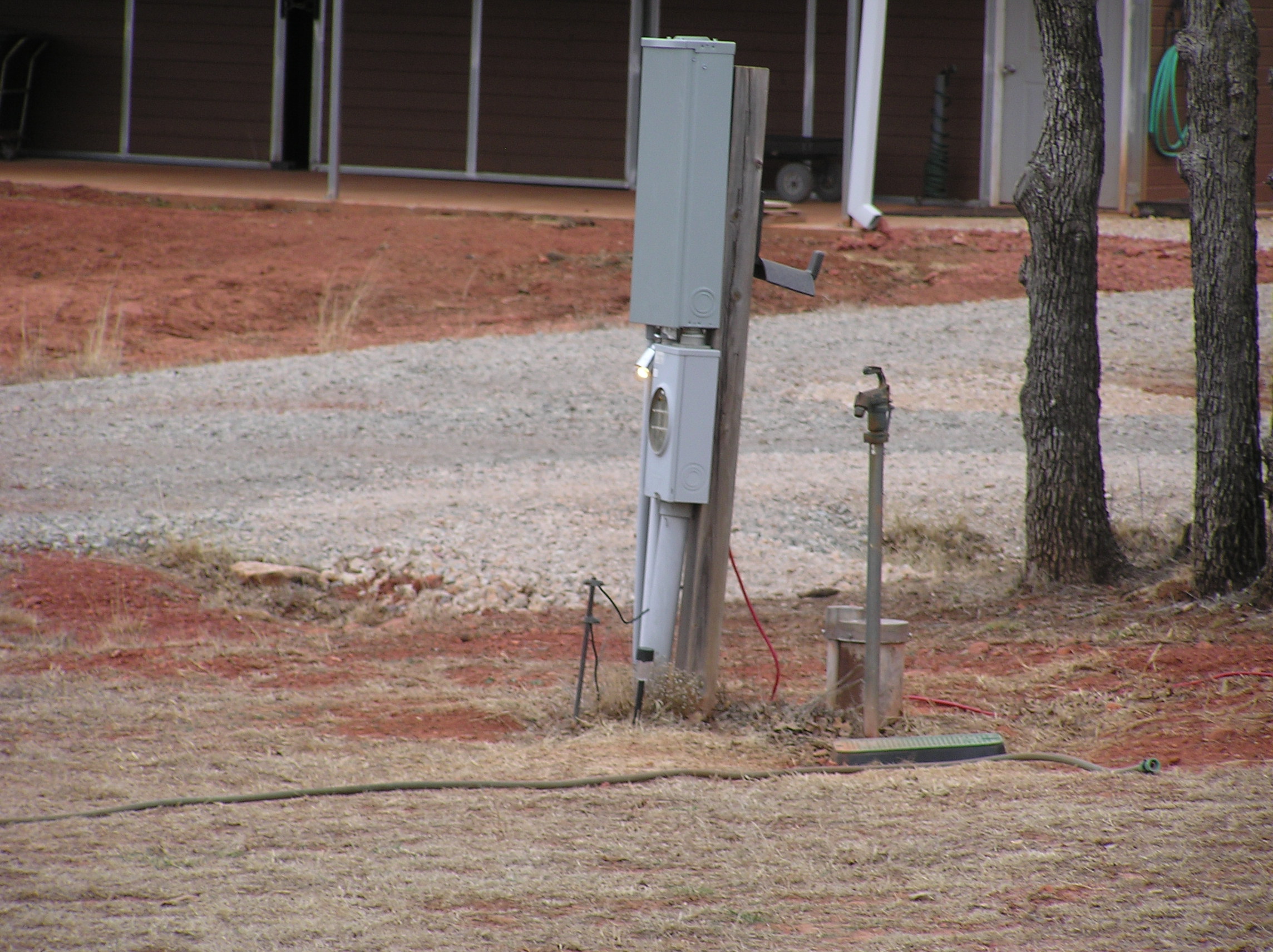

I know when my pump is running, I just look out the window, if the light is on, it is pumping water.
If the light is on when it shouldn't be, I check the toilets and go out and shut off the hydrant at the horse water tank that my wife forgot. :D

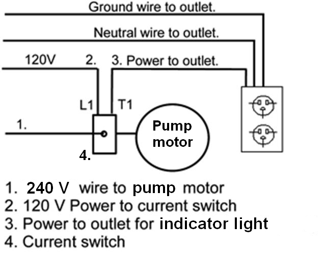

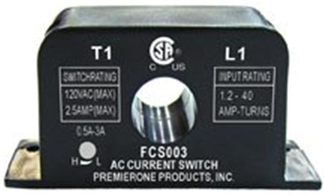

I installed an AC Current Switch on one of the wires going to the pump.
Sure is good knowing there are no leaks in the system. :thumbsup:
