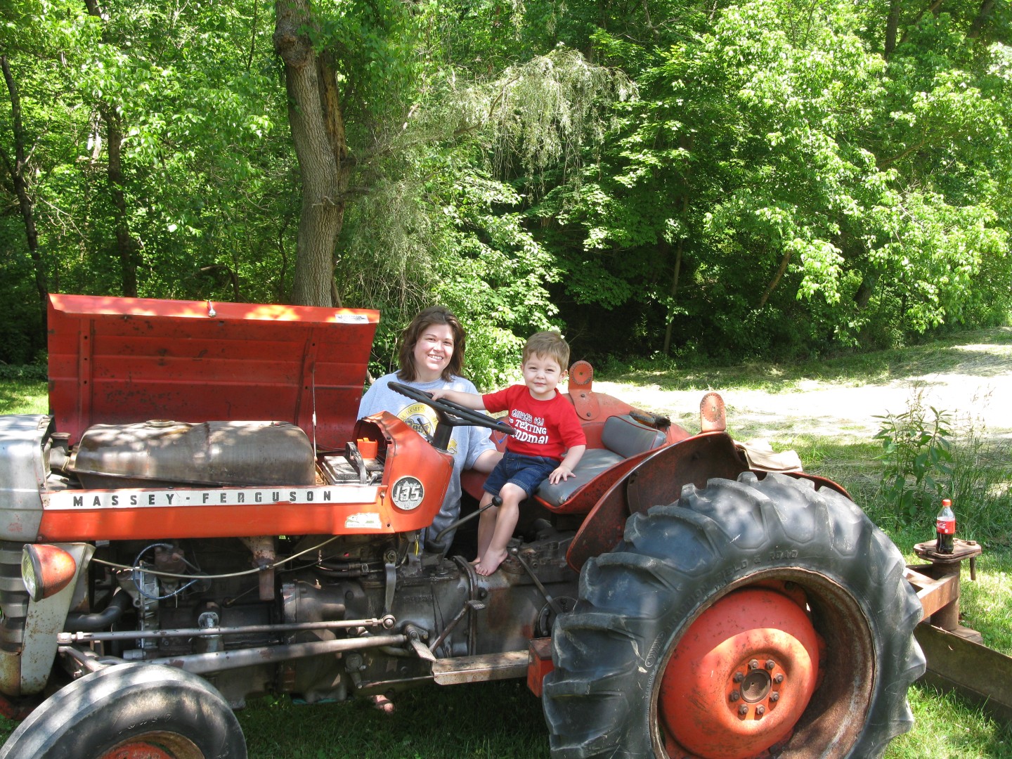

Well, we got her home. My boy Matthew loves it. I thought it may have been rolled but after further study, me and my neighbors believe they dropped a tree across the back the fenders. It needs a few things but runs. Here are some pictures. I only hope I can do half as good a job at fixing her up as the folks on this forum have done to theirs.
Have a good evening.
That's a nice looking Massey 135.
I agree that it appears to have had a tree across the back of it at one time or another. The damage shouldn't be too difficult to repair, but be prepared for possibility of the bolts (2 on each side) holding the fender supports to the axle to be seized. If they are seized, a little time, a propane torch, and some penetrating oil, usually helps them to come loose.
