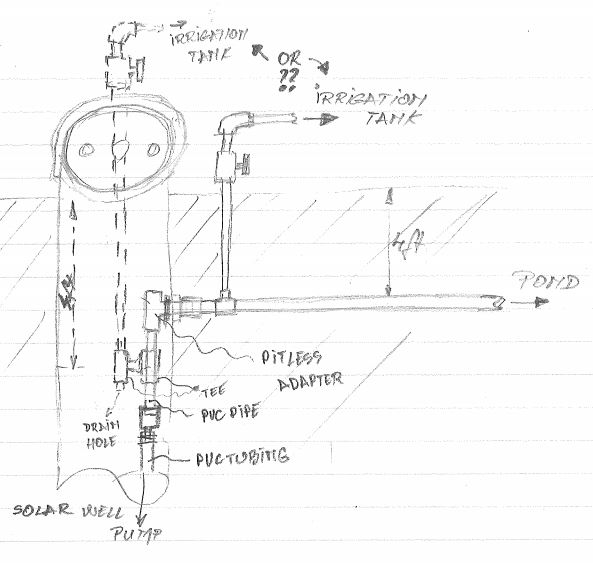

Unfortunatelly our pond doesn't want to fill up to the top so we decided to put a solar well. Below is my plan to setup the well but I appreciated any comments or ideas. The well will provide water for pond but in the same time I wish to have option to use it for irrigation. Because the frosting line in our area is 4 ft I must install the pittless adaptor at that level and put all the pipe in the ground. In order to save some work and not digging, I was thinking to install the pittless at ground level and add a drain inside the well at 4ft. Do you see any issue with this?

I think you run the risk of a backflow condition that could contaminate the well and the aquifer with bacteria.

I forgot to mention that the well is at 250ft away from the pond and at 20ft above.
/ Well for pond setup #4
if an inspector saw any sort of issue with backflow of water back into the well, you would be paying heavy fines,
come out of the well with pitless adapter, come up and out of the ground, then a check valve, then a tee and then one to a tank, and another pipe to pond.
assumption pump down in well also has a built in check valve, if not place check valve as well clear down beside pump. a foot valve normally are check valves as well, ((other words 2 check valves before you goto any thing else))
check valves do go bad over time, "wear and tear" to simple build of crud (hard water for example). so when installing them, make sure you can easily service them / replace them. without having to cut everything out and replace it all with new.

distance from pond wont stop siphoning back to well. You state that the well is 20ft above the pond, but what is the static water level in the well. If the static water level inside the well is lower than 20ft from the top of the well, siphoning can and will occur without a check valve or air gap to prevent it from doing do. Water levels do vary inside a well. The water level will lower when the pump is pumping water and can cause a pretty good drop from the surface of the water to the top of the well. When the pump stops pumping the well will naturally refill back to it normal static level. One would expect the well to refill from inside its own depth, but if the water line is hooked to a external water source, such as your pond, the water can be sucked back into the well contaminating the ground water. Install some sort of airlock or check valve or dont use the well for the purposes you intend.

Your diagram does represent a direct cross connection between the lake and the well. Most jurisdictions will not even allow any type of check valve in this proposed diagram to correct the cross connect because of the likelihood of failure of the check valve. What you want to do can easily be accomplished - you just need to obtain the advise of a competent well driller or engineer.
I strongly advise to NOT install a system as you have pictured. Contamination of ground water aquifers is serious business.

As for the water flowing back into the well, why not just have the discharge be above the pond level? The splashing of the water entering the pond creates oxygen and there isn't any way for the water to go back down the well. I would also pump the water to a storage tank and attach a manifold with valves to drain it to where you want the water to go. As long as it's gravity fed from the tank, you shouldn't have any problem. Then in winter when everything freezes, just turn off the pump and drain the tank. You don't really need the water then anyway.

And your suggestion, called an air gap, IS the easiest method to handle the situation.

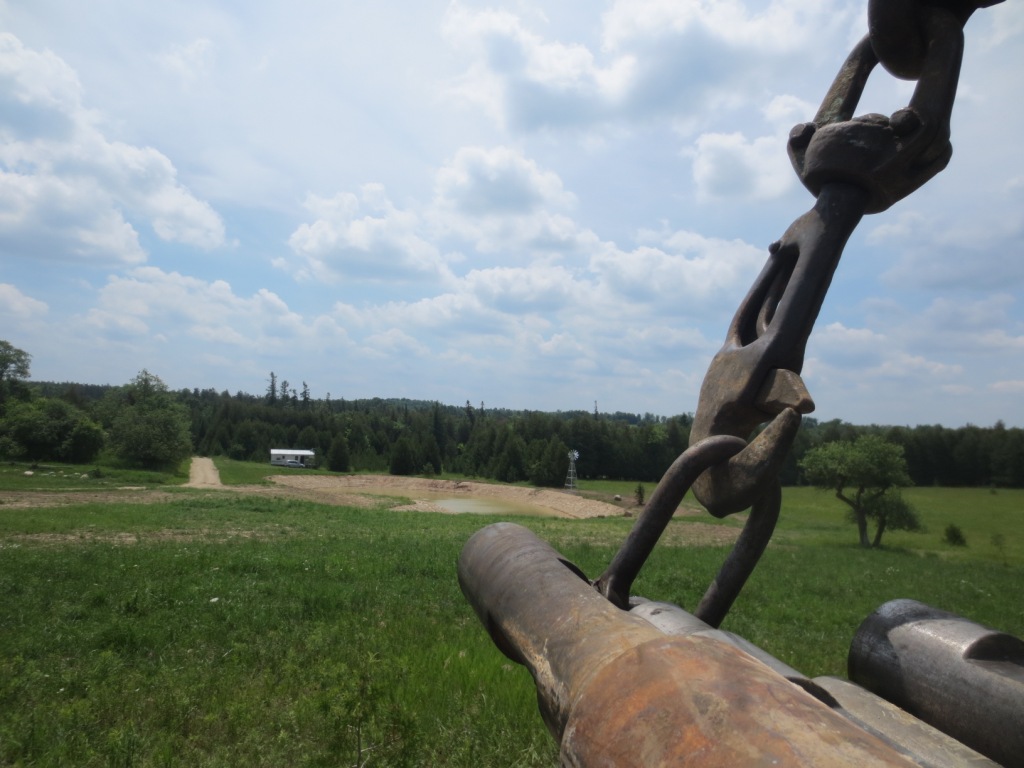

Just to clarify as I see most of you have a concern about contamination of the well. I'm planning to install the pipe above the maximum pond water level. No physical contact with the pond water so not a chance of backflow in the well, even I don't understand how the water can climb the hill. I attached some pictures for reference to show where is the well relative with the pond.
The crew finished digging on Friday and the depth of the well is 120ft, the static water level is at 28ft and the bedrock at 40ft. I asked them why they dag so deep, and they said, they were looking for a flow over 15GPM. I have to trust them as I don't have any experience with wells. I hope they didn't do it as a money grab. Anyhow, quite expensive well so far at a cost of 40$/foot but the good think is they suggested to use the same well for house which we are planing to be at 200 ft from well.
On Monday they will finish to clean the well but they have a concern about the bedrock quality because at the first flash a lot of debris was coming out. The recommendation was to install a liner up to the bottom but that is quite expensive; quoted at 25$/foot. Hope I don't need it, as already this well is over the budged, so I'm planning to install the pump above the bedrock where the flow is around 10GPM.

Looking at the pics of your pond, I'm wondering how it holds water with all that rock? Is this normal for ponds in your area and if so, do they hold water?

Yeep, it's clay with rocks. So far it's just 6ft deep and I need another 4-5ft to fill it up. My east and west neighbors have filled ponds up to the top. For mine, I think the water table is quite low and not a chance from rain or snow. We have just two major rain this year and the pond gained maybe 3".

Nice looking pond. If your pond gained from rain water, at least you know the bottom is well sealed.
