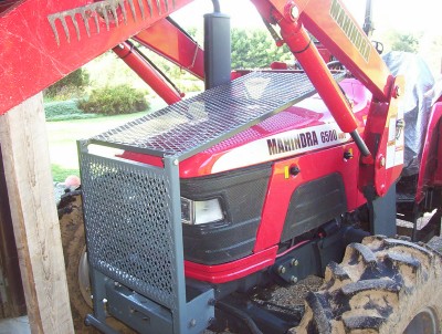

What might be some procedures for insuring that things stay true while welding?
A couple of problems I ran into follow.
On the attached picture...I had the side arms connected, front and back. I tacked on the cross pcs. (light color), as shown. Then I took the whole thing off the tractor to finish welding etc. When I put it back on the tractor, One of the side arms was 1/4" or so off. I could not connect it until I expanded the mounting hole with a file.

In this specific case, I would say that more tack-welds were needed. (If you absolutely couldn't weld it while still in place)

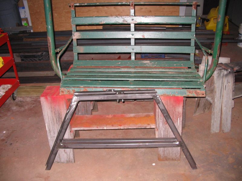

Heat is your biggest enemy. Heat from welding, grinding and sandblasting will cause steel to warp. Spread the heat around by welding a little here then a little bit in another place. Clamping on a welding table will also help.
For my latest shop project, I just finished a set of matching chair legs for an old ski lift chair shaped in an inverted U with the legs and cross braces at 22.5 degrees (see attached picture). When all welding and grinding was completed I was only off about 1/16" but I went the extra step to clamp the legs to my welding table and weld joints opposite each other keeping the heat spread out.

Another problem was welding the expanded metal onto the frame for the Hood protection.
The frame fit perfect before welding the expanded onto it. However aftter welding it "bowed" quite a bit (about an 1 1/2" in middle), end to end. It didn't even come close to fitting correctly. I didn't think that I could stretchhh it back to the intended shape, but I tried.
I shimmed up all four corners 1/4" - 3/8", put a board across the middle, and parked my car with one front tire on the board. I increased the shims each day for four days, and kept the car on it. Lo and behold, it did stretch back to it's indended shape, as shown in pic.

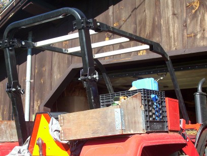

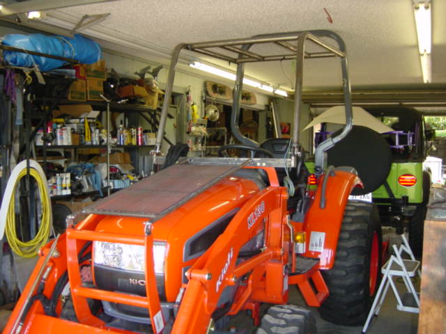

I ran in to the same thing doing my FOPS and hood guard. The hood guard looked like a teeter totter when I was done, I put it in a press and straightened it back out. If you have a T where two tubes come together there isn't too much you can do other than bend it back.

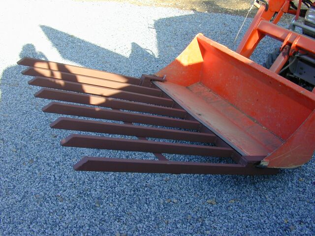

Yeh, same here with my brush forks ... many T-joints. Had to heat every joint and add a strongback to get the curl out of it ... it's always something /forums/images/graemlins/wink.gif
