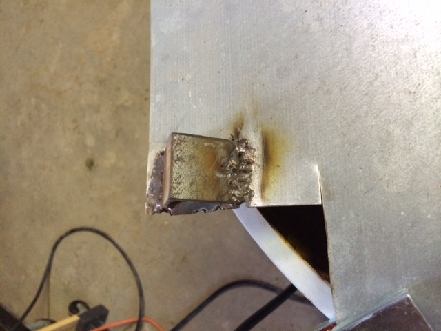

We used to use this on galvanized a lot, and it worked really well and was fairly strong.
One of my neighbors is interested in it as well, it has some good uses for thin sheet metal.

OK, so at 9 PM tonight I finally found time to try it
Electrode neg, 25 amps, sharpened carbon in the PA-300 stinger, and a scrap piece of angle on a scrap of galvanized
The first one was real sloppy, the second one I got a little better
I hope the pics attached, I do not put many pictures on this site
