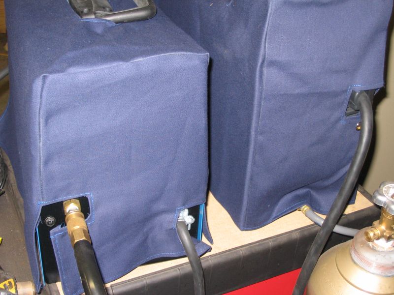

OK guys, here's my first project since buying my tractor.
I decided that I needed to build a shed to keep my tractor in, therefore I needed a welder; after I found a good used welder I needed a way to haul it and the cutting torch around, along with the misc tools that welding always seems to require; so a small trailer was the perfect fit.
I had intended to use an old motorcycle trailer that I had but after looking it over I decided that it would probably be easier to start from scratch!
So, I talked to my boss and was able to work a deal to buy an old air compressor trailer that our business no longer needed.

You might want to consider adding a piece of sheet metal on the front uprights. The first time you pull that when it's been raining, you'll have road spray all over everything. I'd also suggest getting covers for the welder and tanks for the same reason. The sheet metal will deflect about 80% from your vehicle, but road spray from oncoming vehicles (like 18 wheelers) gets all over (and in) everything it can.
