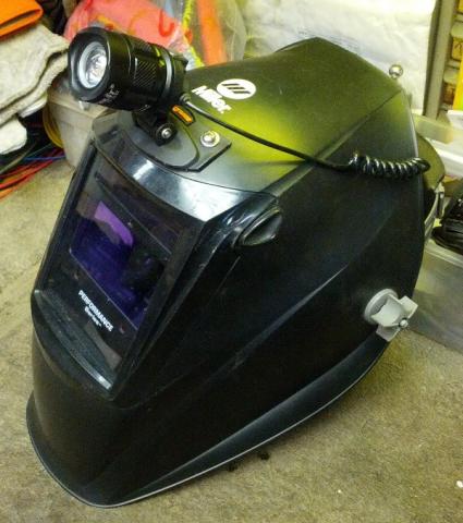

With so many welding videos out there already (some good-some bad) it may be hard to find subject not covered....
BUT one thing that seems to be lacking is "seeing" your "weld".... I mean like adding a headlamp on helmet to add more illumination for weld path, adding magnifying lenses to hoods, looking at arc/puddle from side of MIG torch instead over top to see what the puddle is actually doing, maybe getting cataract surgery for old eyes....
All things that help my 75 year old eyes and improves my welding.... Subject has been introduced some what a while back in "Weld Talk" the Hobart site but there does not seem to be any real coverage on subject...
(not mine, pic lifted off i-net)
Dale
Adding an LED spot light to my helmet is something I would really like to try. Might have to see if I can easily mount my camping LED headlamp to my helmet.
