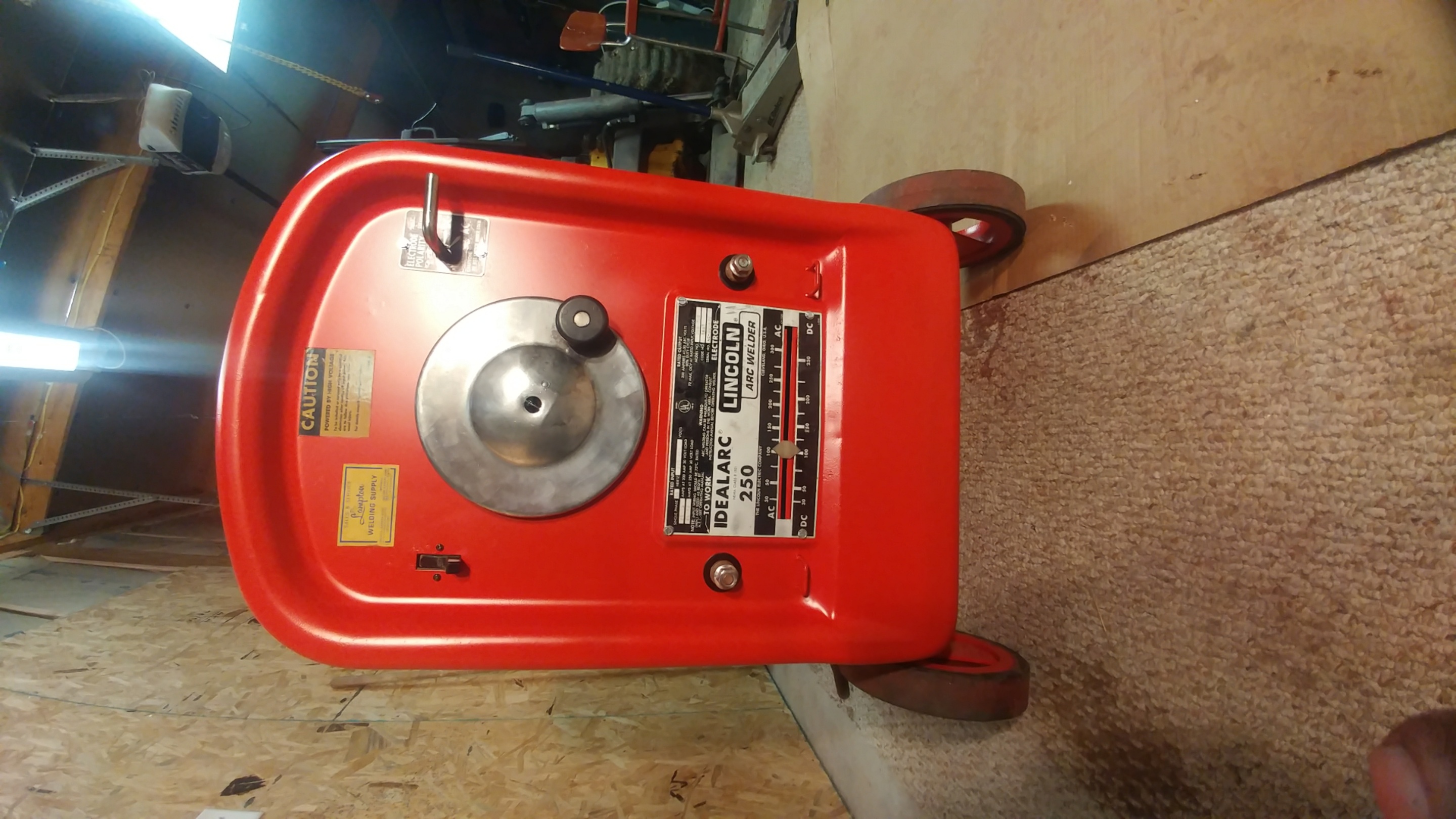

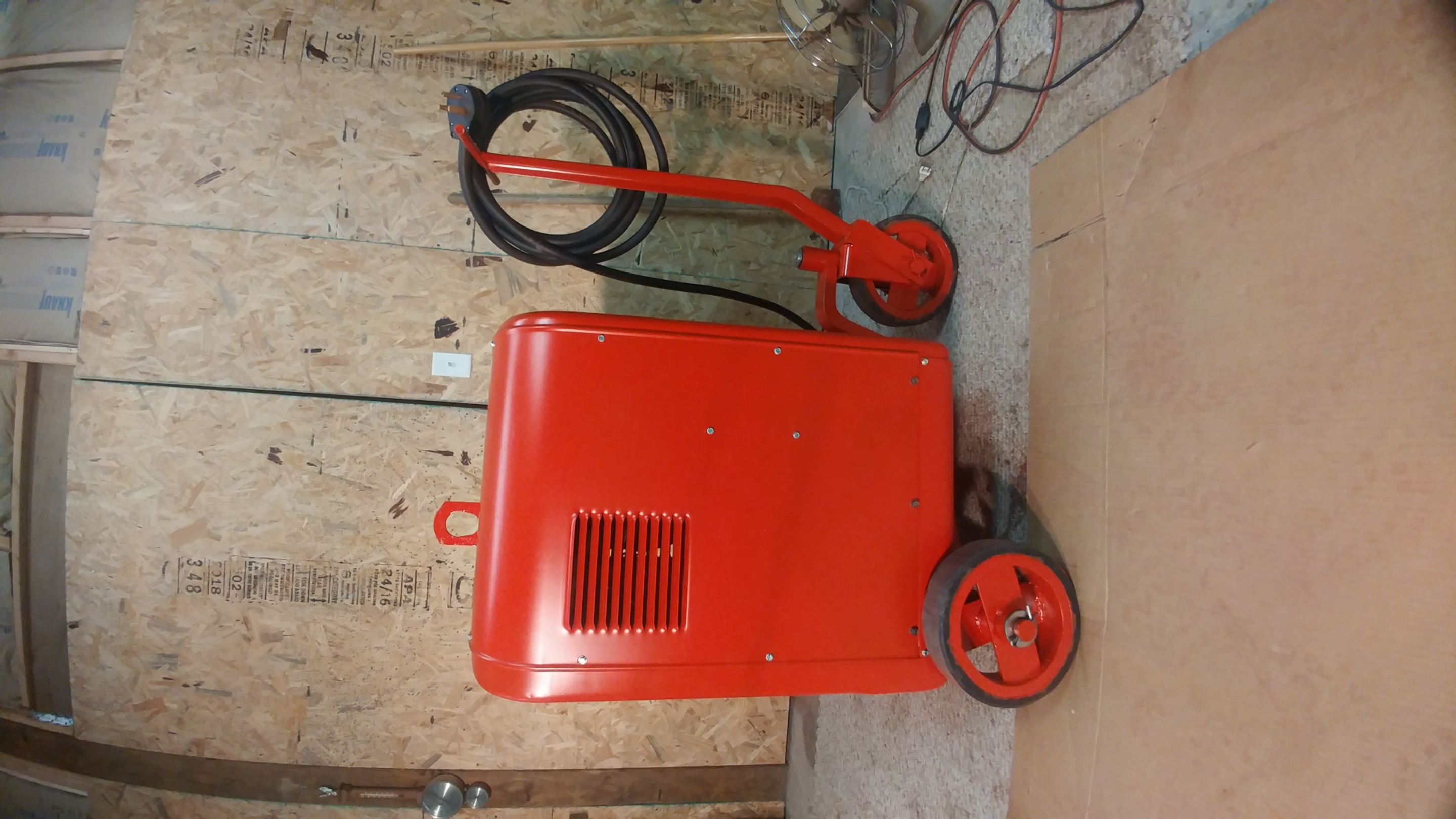

arc, i arc everything........have for years love my idealarc 250 welder front 1.jpgwelder front 2.jpgwelder left side .jpgwelder right side.jpg
