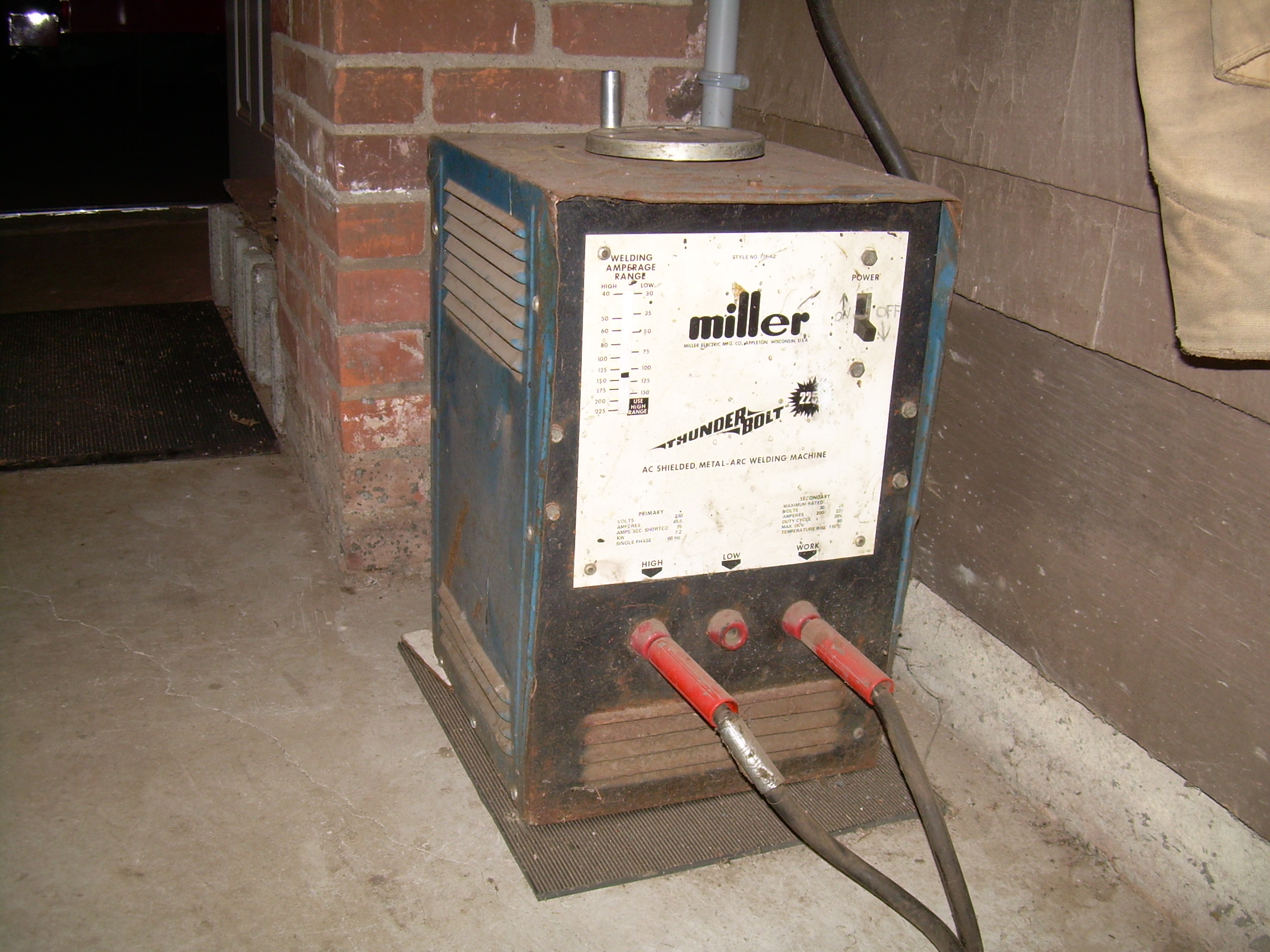

You can get into a used "Tombstone" style welder cheap. Id look for a ad/dc machine if possible.Id recommend a Lincoln or Miller. Those tombstone style machines are pretty much bulletproof and dont mind being left out in a barn. It would give you lots of flexability. With the right rods you can weld pretty much anything. "Stick" welding is also alot more forgiving of rust, dirt and grease like you'd see in on farm equipment.Mig would be alot easier to learn but way more $$ to get a machine with enough power to weld farm equipment on a regular basis and would require more prep to the metal before welding.. A used torch would be very handy too for heating and cutting purposes.
