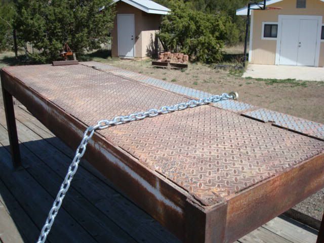

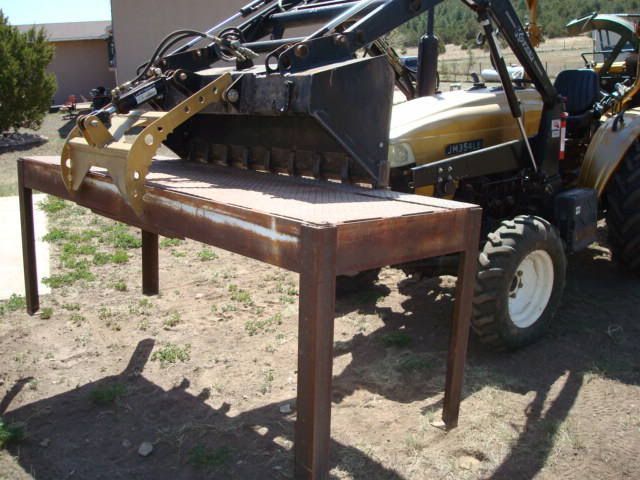

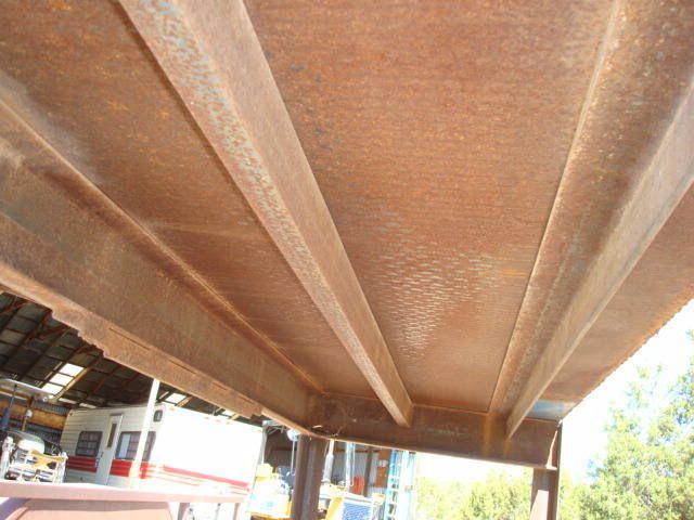

I got this table off Craigslist, not exactly what I would have built but the price was right... It has served me well for many years.
Larry,
What do you think of the diamond plate surface? I have some 1/4" 3'x5' diamond plate here that I will probably make a welding table out of but I was planning on turning it up side down so that I have a smooth surface. I assume that would be better, but did you find an advantage to the surface you have?

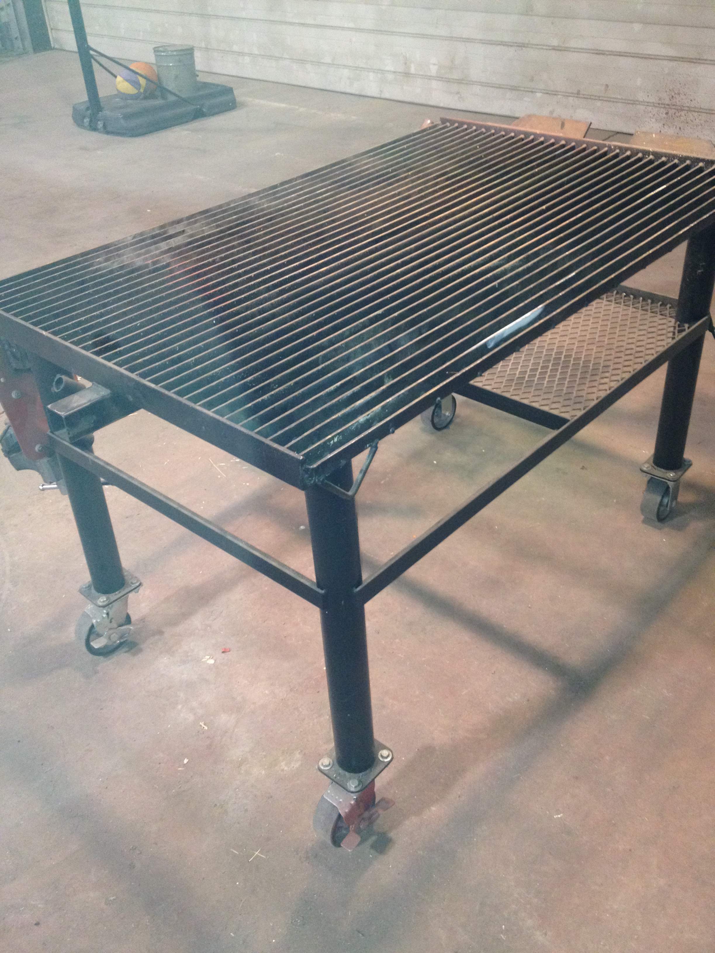

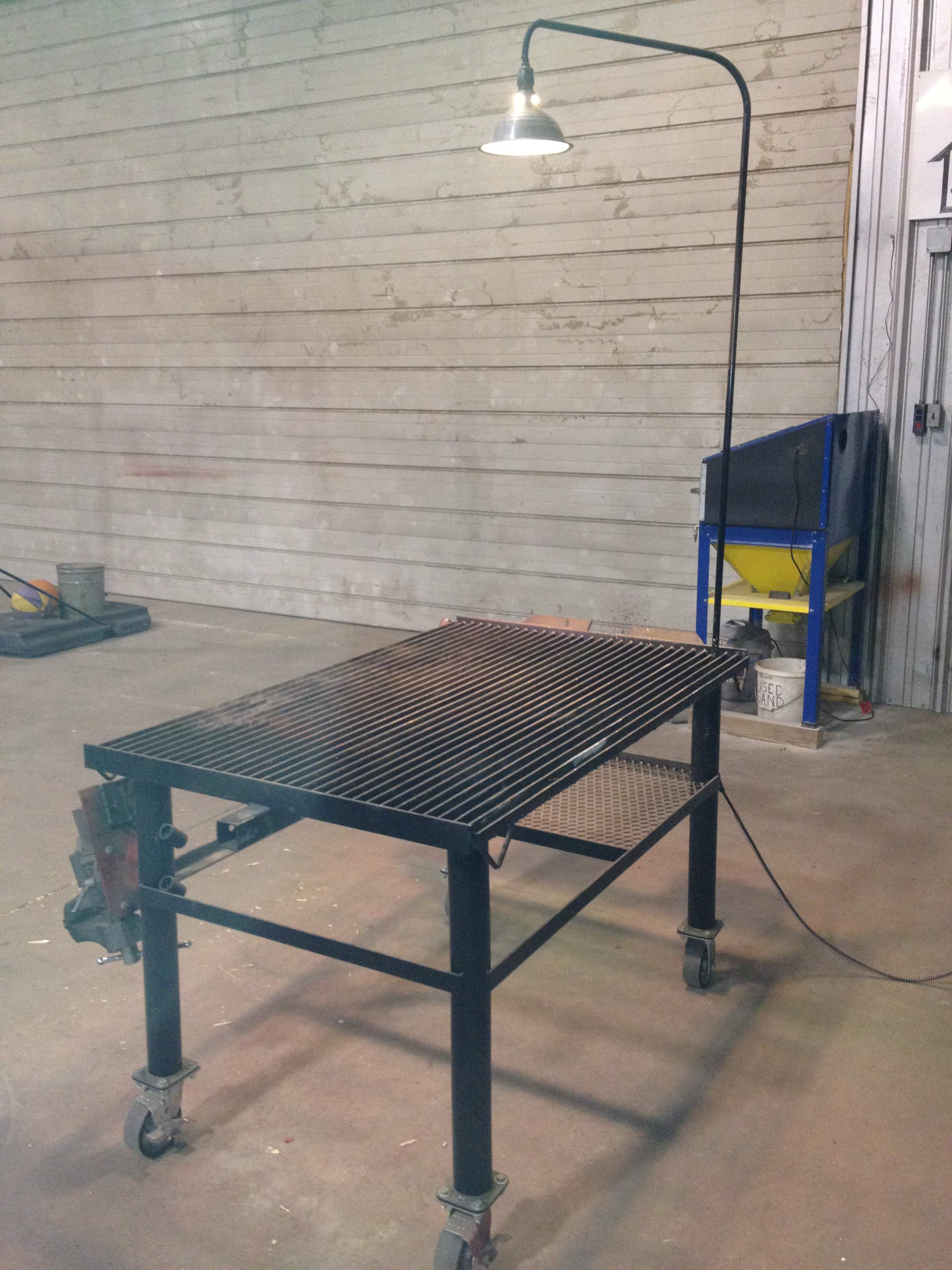

Here's mine. Got the grate from the old high school welding shop for 20 bucks. Had some 3" heavy wall tube laying around and added a 1/2 bottom shelf with expanded, overhead light, and 2 pcs of 5" angle iron with the V open for clamping and welding round parts. Added some 4" castors to move it around easier. Also added square tube to hold either a small vise or my hand shear reciever hitch style. I built this the same height as my main workbench so it does double duty holding long steel or wood projects.
Nice thing about the expanded and the grate is all slag and junk falls thru to the floor.
