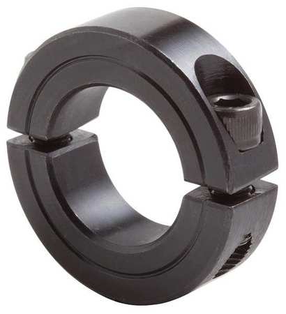

I like it! Maybe a 2 piece shaft lock color on the threads to keep it in place?
