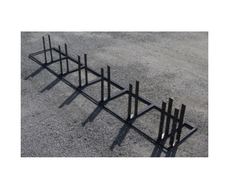

Just made this yesterday, I’m just wondering if it’s obvious what it is.
It’s a little over 8’ long, about 17” wide. most of the frame is 3/4 angle, the cross pieces are double 3/4 angle, the 14 verticals are 1 1/2 x 1/8 by 15” long. 5 holes drilled in each vertical piece.
The long edge on the right has a 3/4 solid square welded on the full length of that side only.
I didn’t take any close pictures of the welding. besides I did a lot of grinding what can I say.
Is it obvious to anyone?

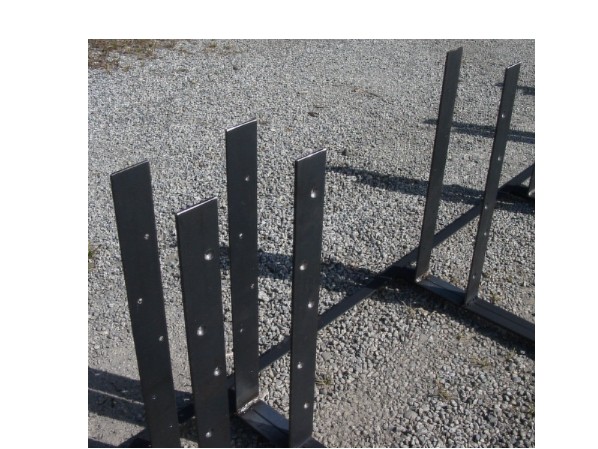

70 + views and 1 guess, that tells me it’s not all that obvious. Its like any thing else I guess, once you know what it is then it’s obvious.
Ok a couple of clues:
It for inside a house.
The spacing between verticals on the same bar are 3 1/2 in apart.
Each set of cross bars is 16” apart.
The orientation in the picture is upside down.
the attached picture shows the holes countersunk for wood screws.
